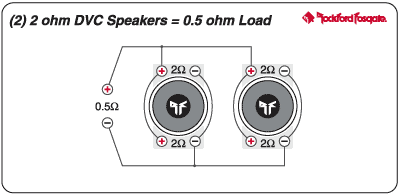

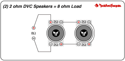

Here's the wiring options you have for 2ohm DVC's...
Best one for a class D amp (or class AB 2-channel amp bridged to 1 channel) that is 2ohm stable using 2 2ohm DVC subs
amp for Power HX2 - Last Post -- posted image.
Other Mono/bridged configurations for 2 2ohm DVC subs
Best one for a Class AB 2-channel amp using 2 2ohm DVC subs (1 sub per channel, or only running 1 sub per mono amp)
Other Class AB 2-channel amp configuration using 2 2ohm DVC subs (1 sub per channel, or only running 1 sub per mono amp)
