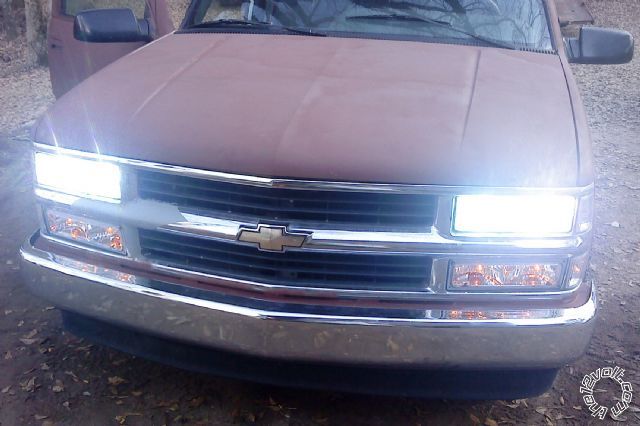

kstephens1223
Member - Posts: 6
Joined: November 18, 2010
Posted: February 27, 2011 at 6:12 PM / IP Logged
hey thanks alot man, works great, and it was positive switch

afdanw
Copper - Posts: 74
Joined: August 06, 2010
Posted: February 27, 2011 at 8:38 PM / IP Logged
Good stuff man.  Glad it helped.  I figured it was most likely the posative switch, most cars are.  My saturn is the only one i have ever seen that was a negative switch.  Looks good.  enjoy blinding the entire road with your high beams.
