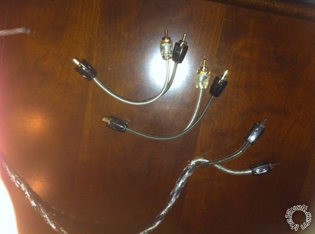

The guy at the sound shop told me since my head unit only has front and rear RCA's on the back i needed these
1997 vw jetta gt complete upgrade trouble - Last Post -- posted image.

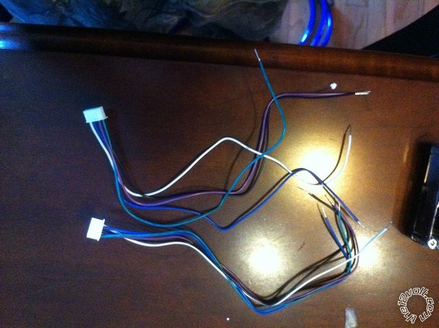

he also recommended using speed wire to bypass the premium audio in my car.
i have no idea how to do that? all i know is that he said to hook one end to the harness of my radio and to run the other end back. 1997 vw jetta gt complete upgrade trouble - Last Post -- posted image.

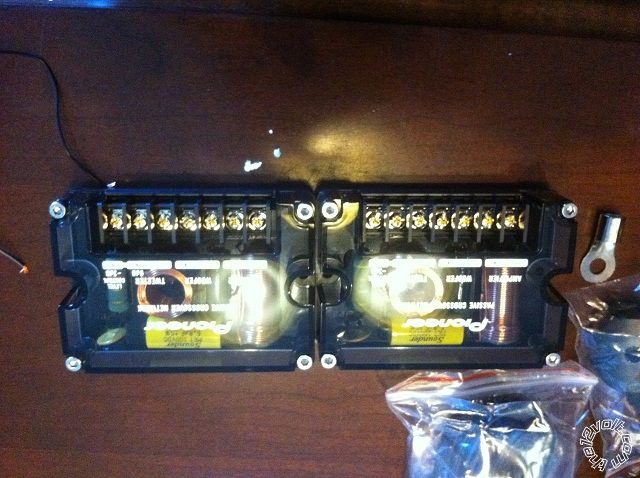

how do i run and wire the two passive blocks?

Rca adapters is ok,Power wires are ok,Crossovers wiring look at the connectors, input= speakers wires coming from amps. front -rear-left and right.
Outputs 2, one output (+and- wires) tweeters
 other one (+ and - wires) mid range speakers
you will need 4 crossovers.
You do not need speed sensor unless it is for navigation system.

Thanks for your reply I've figured out most of it, but I have 2 last questions, can I leave two tweeters hooked up and powered by my HU? What do you mean speed sensors.?
