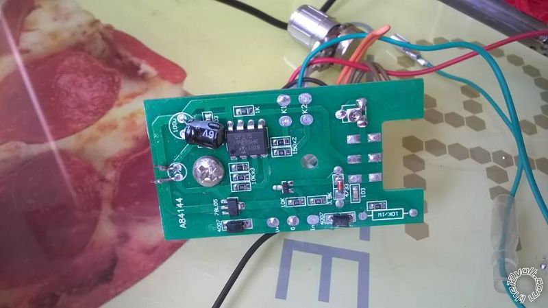

I was trawling the internet for help and i came across this thread, so i thought i would resurect it. I have just bought the same style shift light although a much updated version looking at the difference in the circuit boards....
how to wire a 12v light to a led circut - Page 2 - Last Post -- posted image.
my (probably stupid)questions are, how does this shift light work? you adjust the knob to what rpm you want the light to come on, but how does it know??
secondly, the output to power the LED (has been cut off in the pic, l/h side) is only 5v. is it possible to increase the output to 12v to power an external led that i already have, or will i just need to replace mine with 5v led's?

Posted: November 07, 2016 at 11:52 PM / IP Logged Link to Post Post Reply Quote KPierson
Most modern shift lights measure frequency of either an injector or coil (or other pulsing signal that changes in a linear fashion with RPM). The pot is most likely creating a 0-5vdc signal that is going back to a processor that is converting the analog voltage to a digital representation and then comparing that value to the measured frequency. If the frequency value is lower than the voltage setpoint the light comes on.
You could add a transistor inline with the output to drive your 12v LED.
