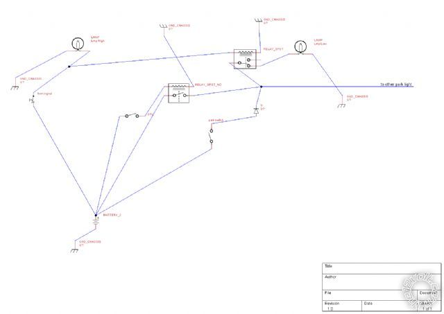

I've got a diagram, but i want to see if it is electrically sound. What we are trying to accomplish is this. He wants he wants the front parking lights on during the day. When he turns on the turn signals he wants the parking lights to go off when the turn signals come on, alternating.
webelectric drl - Page 2 - Last Post -- posted image.

daytonboi
Member - Posts: 27
Joined: August 16, 2010
Location: Ohio, United States
Posted: January 06, 2013 at 2:55 PM / IP Logged
Here is a larger version

oldspark
Gold - Posts: 4,913
Joined: November 03, 2008
Posted: January 06, 2013 at 6:23 PM / IP Logged
That will flash but out of phase with the front & rear bulbs.
I have a preference for dioding the relay coil rather than dioding the loads (co-located diodes, less current, and full voltage to the load/lamp)
Hence I'd move the park switch connection & diode to the SPDT relay coil and (therefore) also insert a diode from EACH flasher feed to the coil (remember, the flasher can is before the L-R selector switch; it's the same as sampling the flasher bulb - NOT sampling the flasher can itself).
Hence 4 diodes which can be any 1N400x type (eg, 1N4004 etc), and 2x SPDT relays (one for each side with the dioded park switch feed to both coils).
That overcomes the need for a diode rating to handle the Lmp low current, though if they are the typical 3W bulbs etc (or LEDs), that's only ~250mA and well under the 1N400x 1A rating so your 2x single diode method could be used.
It's a pity the Low Lmps are hard grounded. If they had a wired ground, the relays would not be necessary for this type of "out of phase" flashing.
