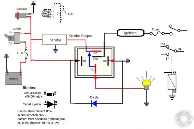

What I want is whenever I switch ON the Ignition, my eagle eye lamps come on automatically as work as DRL and a switch that change the mode of the lamps from permanently lit (Daytime light) to Strobes through Strobe module. As I already said please ignore my dumbness as I don’t know much about wiring.
I have made a Diagram of the same but don’t know if the MODS will allow me to post the same.

Your wiring is correct EXCEPT swap the 87 & 87a, and 87a will go to your IGN +12V.

Ok, devilonwheels was nice enough to PM me with his diagram.
I made a few changes as well as adding some supplementary info like my equivalent SPDT relay "circuit" depiction, and diode symbols and bodys.
I also included a pic of another thread's LED rocker switch just to show another possibility.
And devilonwheels has decided for Strobes at any time (ie, not requiring IGN or ACC) which would have been my obvious choice.
And devilonwheels included the protection diode across the relay (excellent!).
drl and strobe - Last Post -- posted image.
I can't see any problems. But if anyone can...
