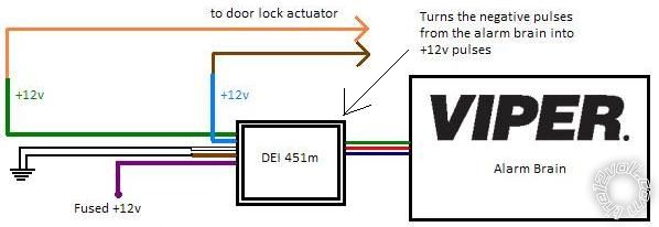

heres the diagram for the DEI 451M "since i just figured how to upload pictures."

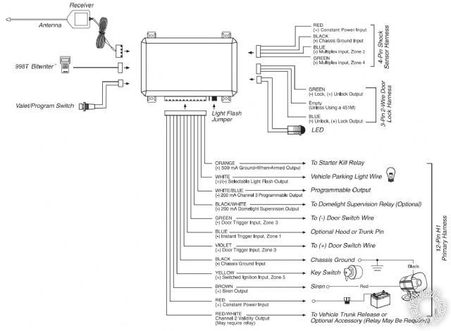

Viper 350HV wiring

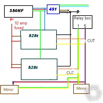

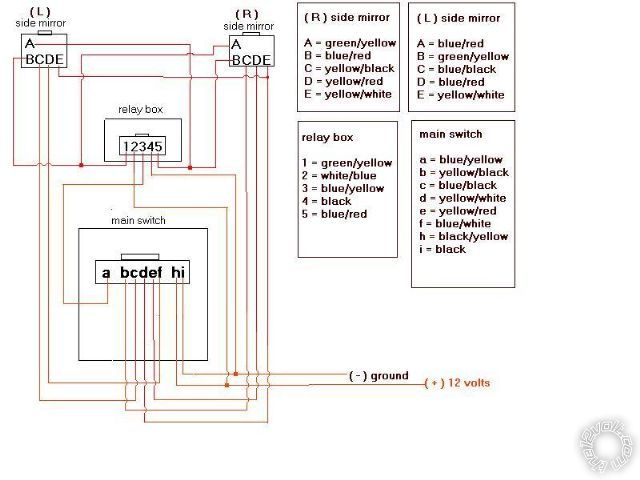

here the wiring diagram for the mirrors to the OEM relay box and to the main switch diagram
power folding mirrors - Page 2 - Last Post -- posted image.
hope this helps with the wiring diagram :D
Posted: January 30, 2013 at 11:12 AM / IP Logged
I wish I could cut and paste your pictures but anyway much less confusing now.
Take the blue and green from the cable from 350 to 451 join to the BLACK/ white on each 528t
Use a 10 amp fused feed to joined red and brown on 528ts, to ground, 451 BROWN / white, WHITE/ black and blacks from 528ts.
Cut the RED / blue and the GREEN/ YELLOW between the mirror fold switch and the mirrors. In other words at 1 and 5 as per that diagram.

the wiring diagram you gave me should work open and close mirror when the alarm arms and disarms correct. i dont have a factor alarm or factory door locks.
also on the second 528T do i leave the blue loop un cut? the first 528t was cut. thanks again
Posted: January 30, 2013 at 11:34 AM / IP Logged
OK, Don't cut the loops. That determines the input polarity on the BLACK/ white 528t wire, uncut = NEG, cut = POS, that would explain fuse blowing since those wires REST AT GROUND.
so on both of the 528t blue loops leave uncut? i really appreciate your time in answering my questions.
