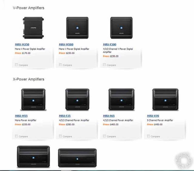

What you need is a good quality amplifier that can deliver a solid 500 watts or more under real world conditions. Inferno and Nitro are not good bets for this. Alpine makes several great amps starting at $230 3500 watt amp for two 1500 watt 12's? - Last Post -- posted image.that would suit your needs quite well. If you have a few more bucks to spend than look at JL Audio JX or XD series amps.
When buying an amp saving 50 or a 100 bucks will only ensure that the 100 or 150 bucks that you do spend will be wasted.
