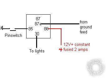

I'm probably overthinking this, but I need help to temporarily break a connection with a ground and then have the connection returned when the ground goes away.
Here's what i'm trying to do:
I have emergency lighting on a pickup truck (hide-away LEDS in taillights). What I want to do is have a pin switch mounted so that when the tailgate is closed - lights function normally. When I open the tailgate, pin switch grounds and turns lights off. When I close the tailgate - lights come on again. Basically using the ground as a secondary on-off switch.
I have played with the RAP relay without diodes and it is basically what i'm looking for with the exception being that it does not re-energize when the ground is removed.
Any ideas would be appreciated.

This, one 5 pin (87a) relay.

Noting that in Howard's break_a_circuit.bmp, the #30 & #87a can be in the light's +12V feed assuming the lights are switched with a +12V switch.
The +12V feed to #86 would also be taken from that switched +12V source. (Hence the relay is only activated when the lights are on.)
I can't find a suitable diagram in the12volt's Relay reference pages (surely one exists?!), but there is an equivalent by HotwaterWizard noting that its 86 will go to the +12V supply (eg. #30) and the pin (key switch) is to GND...
using a ground to break connection - Last Post -- posted image.
FYI - the way it works is that 30 to 87a is NC (Normally Closed {connected}) when the relay is de-energised.
When the pin switch connects (tailgate open), the relay energises and switches 30 over to 87, hence breaking the "normal" feed to the lights.

Thanks guys! That will do exactly what I need.
As suspected, I was overlooking the less complicated solution and trying to make it more complicated than necessary.
