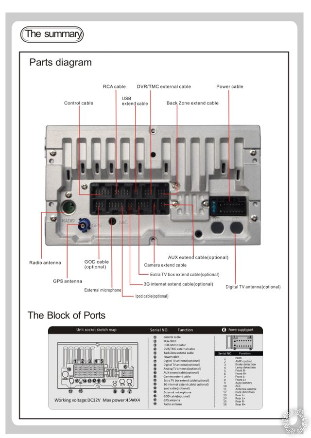

Hi - I'm installing a Chinese made DVD/GPS system in a 2009 Honda Civic. I'm finding this to be a difficult task, partly due to my lack of knowledge and partly due to the abysmal 'instructions' included with the unit.
Here is the link to the manufacturers web site, showing the model I purchased:
http://www.roadnav.com.cn/show_content.php?id=67
(I've tried to upload an image of the back of the head unit. It might appear at the bottom of this post.)
There are 4 wires coming off the harness that I'm unsure about. The first is a solid orange wire labelled AMP-C. Web research led me to a wiring diagram that called it an Amp Control. I don't have an external amp; just the amp that is integral to the unit, and standard factory speakers. I'm guessing I don't need it, but I wish I knew what it was.
The second is a blue wire, labelled ANT-C. The same wiring diagram identified it an Antenna Control. I have the standard Honda factory radio antenna. I have no idea what this is intended to do, or if I need it.
The third is also a blue wire labelled BACK. The web wiring diagram identifies this as back detection. I'm guessing that this is intended to switch the 8" display to display a backup camera signal, but I have no clue what to connect it to. The head unit has a separate connector for a backup camera, which provides a 12V power source and a yellow RCA plug for the video signal. That part I can handle; I just don't know what to do about the 'back detection' wire.
The fourth wire is a blue wire with a white stripe labelled BRAKE. The web wiring diagram identifies this as brake detection. I'm guessing that this has to be connected to the hand brake in some fashion, in order to convince the unit that the vehicle is stationary so that DVD signals can be played. Any thoughts on whether the unit is looking for a ground connection, or 12 volts... or what? (Clues: The troubleshooting section of the manual contains the following statement. Phenomena: No image: PIC OFF is shown. Cause: you fail to connected the manual brake wires or fail to turn on the manual brake. Solutions: connect the manual brake wire and when turn on the manual brake.)
I'd sure appreciate any clarity that other members might be able to provide.
Thanks!
unknown wires in chinese dvd harness - Last Post -- posted image.

I am not real confident in the colors you have posted. Industry standard states Blue/White is amplifier turn on. You have Blue/White listed for another purpose.   But it is Chinese, you may do some more research to make sure you have the colors correct.
Amp control = amplifier remote turn on. Connect this wire to the remote connection of your amplifier(s)
Ant Control = the wire that would raise and lower your antenna if it was of the powered type. If your antenna adapter has a blue wire on it, connect it to that wire. Or if your antenna raises and lowers, connect that wire to the blue wire of your vehicle wiring harness.
BACK = 12 volts from your reverse lamps. This will switch to the back up camera input on the back of the deck. If you have a reverse camera installed, you need to power the camera and this wire with 12v from the back up lamps. No camera = no connection.
Brake = the single wire at the switch mounted to the pivot point of your parking brake pedal or lever.

Regarding the brake sensor wire: when the parking brake is engaged, do you know if 12 volts flows through the switch? Or does applying the parking brake connect the switch to ground?
Regarding the backup camera sensor wire: OK, so I need to connect this sensor wire to the backup lights power in the trunk of the Honda Civic. I wonder if I could tap in to the backup light circuit somewhere under the dash, or the fusebox... but it might be simpler to just run the extra wire to the rear. I'd be interested in your thoughts.

You can find the reverse lamp wire in the loom in the front of the car. But, you do have to run the video cable from the camera to the deck. So instead of spending ANY time at all trying to find it in the front, just run a wire with the video cable.
The parking brake circuit applies ground to that wire when the parking brake is depressed or lifted.
