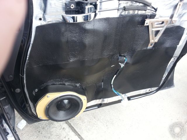

my front doors started out like this
how to step your system up a notch - Last Post -- posted image.
only a single layer of sound dampening material, this seemed to be great at first, it stopped a ton of road noise but i guess over the two years of driving and vibration from sound it may have loosened things up a bit.

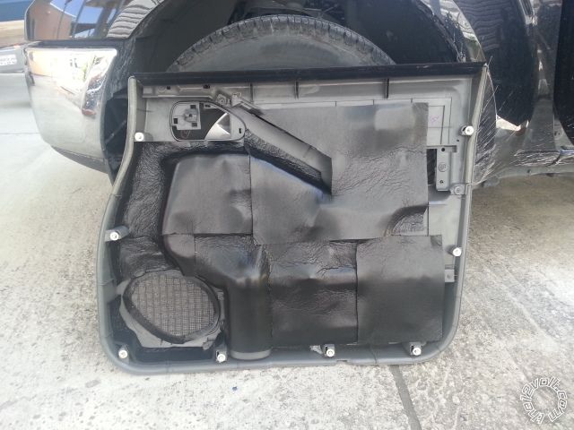

did the door panel:
before

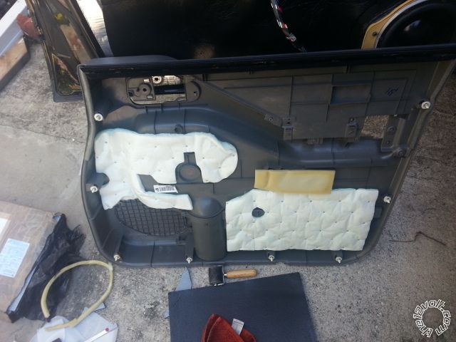

after

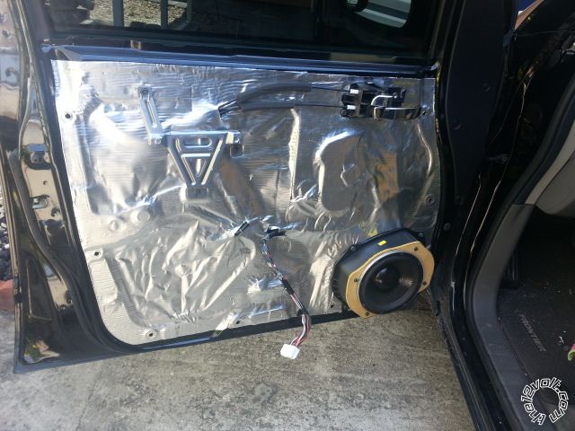

and decided to go ahead and go over the door skin itself too.

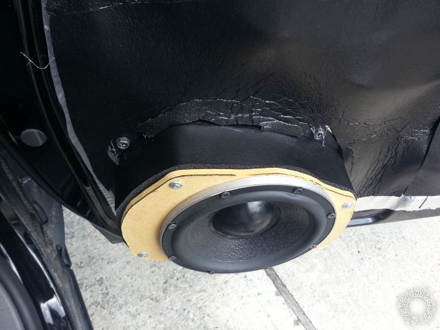

i thought it would be a good idea to wrap the plastic speaker pod/mount to deaden it up a bit
now if you want to do this i should warn anyone that using a thick mat like this can cause a fit problem with your door panels if you use too much or use it in the wrong spot. i took a gamble with using basically 2 layers of 1/4" mat, a 1/2" total of extra clearance and honestly if my door panels were not already so weak and flexible i would have had a big problem when i went to put the doors back together. and it still took a little brute force to get the bottoms to snap in.
the results are nothing short of awesome, bass is tighter, mid is cleaner with less peaks and resonance, i can turn the sound up a little more without feeling like its too much or sounding like the mids are about to explode. its nice, best $60 i ever spent. i highly recommend it
