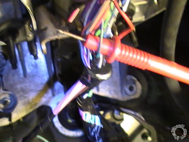

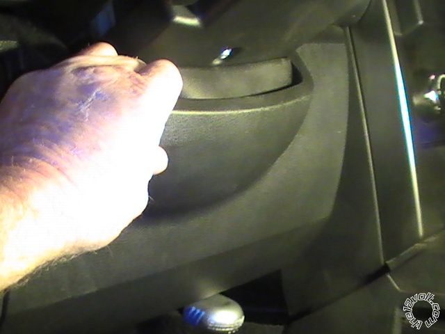

This one would NOT do the TACH through the DB-ALL in D2D. Don't know if W2W would have been any different, so I ran the tach wire out to the fuel injector. Lots of room under the dash, just like the Dodge Nitro, and a easy access grommet to the engine compartment, left side of drivers side firewall. Lower steering cover is removed by taking out three torx screws. T-15 I believe.

Remove lower dash panel by pulling down from top and sliding left.

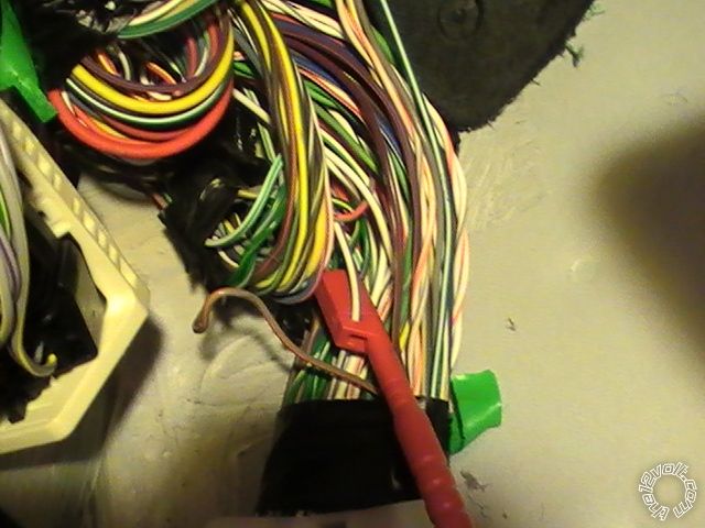

Brake Switch Harness
2010 Jeep Liberty Remote Start Pictorial - Last Post -- posted image.

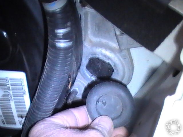

Nice Easy Grommet to Engine Bay

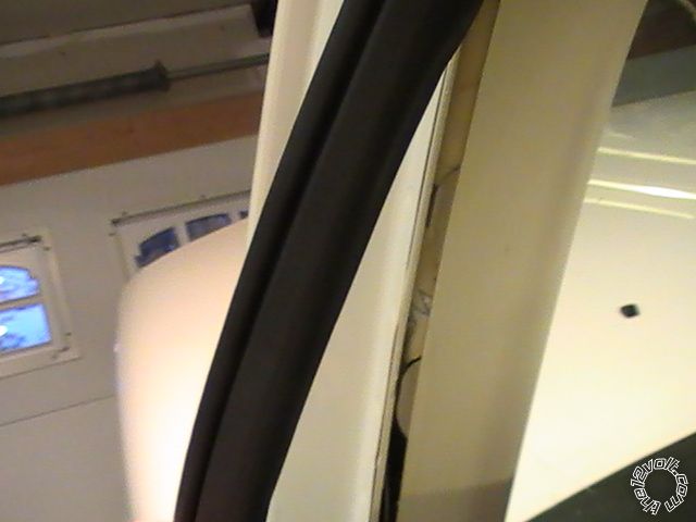

Ran Antenna wire behind weather strip. Lots of room. Notice "A" pillar air bag.

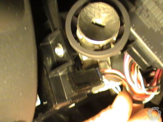

Connector on right contains MUX, Ignition, CAN High, & CAN Lo

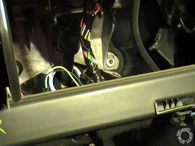

Horn wire in steering column wire harness

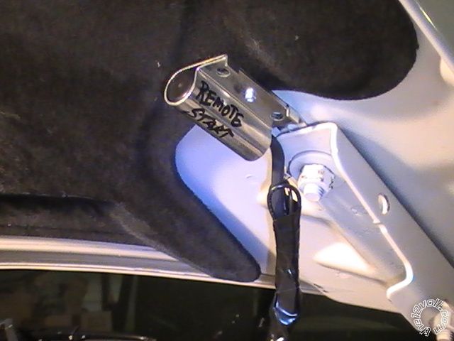

Hood Safety Switch.

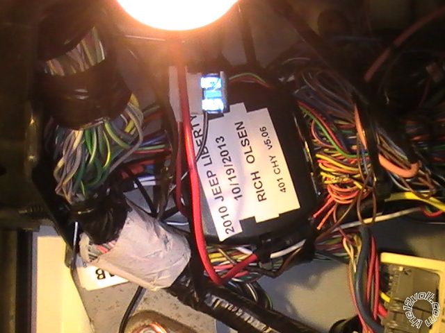

All bundled up and tucked away.

Really like the rust-proof Hood Pin and the info label on the bypass.   2010 Jeep Liberty Remote Start Pictorial - Last Post -- posted image.
