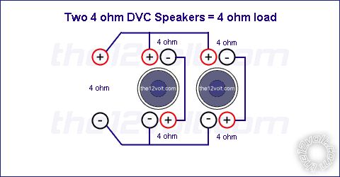

subwoofer wiring? - Last Post -- posted image.
Is it this one I'm suppose to do?
Platinum - Posts: 13,726
Posted: March 20, 2014 at 9:30 PM / IP Logged
That would be the way to do it if you had 2 dual 4 ohm drivers.
Your only real hope for near about the same output from each driver will be to parallel the coils of the dual 4, and wire that to one channel of the amp. Then wire only one of the 2 ohm coils to the other channel of the amp. This will net a 2 ohm stereo load which is EXACTLY the same as a 4 Ohm mono load.

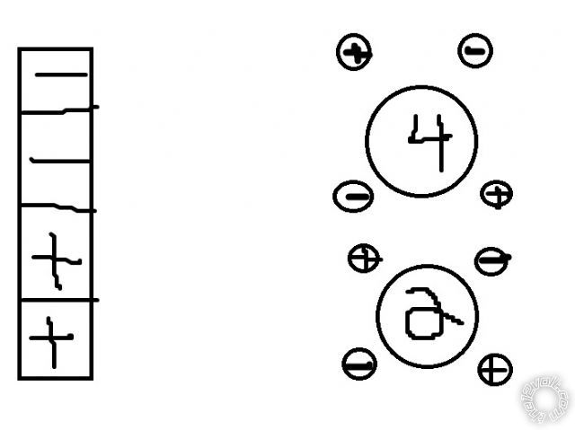

rsilva87
Joined: March 20, 2014
Posted: March 20, 2014 at 10:04 PM / IP Logged
Like maybe just draw some quick red and black lines on this so I know what your talking about haha? If it's not to much trouble.
