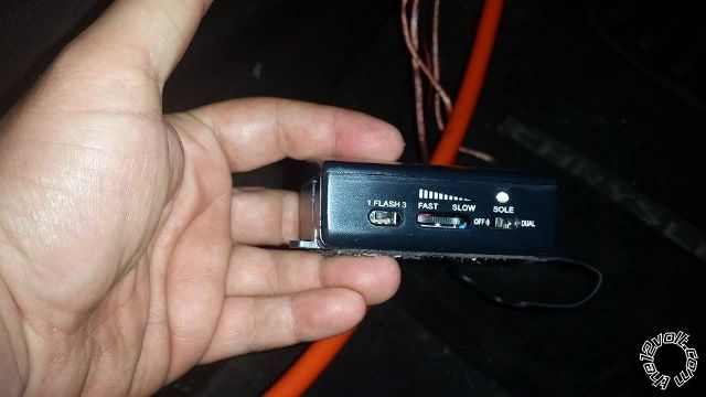

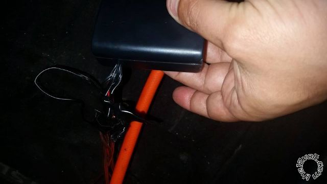

this is what i have.. a simple strobe box, in the back it has 4 sets of wires each set has a neg and pos wire to you can hook up four nights

So it's not a common GND? Then my previous may not work.
Some strobes work using multiplexed signals - their GND is a part of that signal.
If it were common GND, another way is to connect it via a diode and insert a diode in the OEM flasher wire to the LED. That'll mean that the flasher will flash it on, but when not flashed on, the strobe will be lighting the LED.
You have to specify how the strobe works and is wired to its LEDs.
