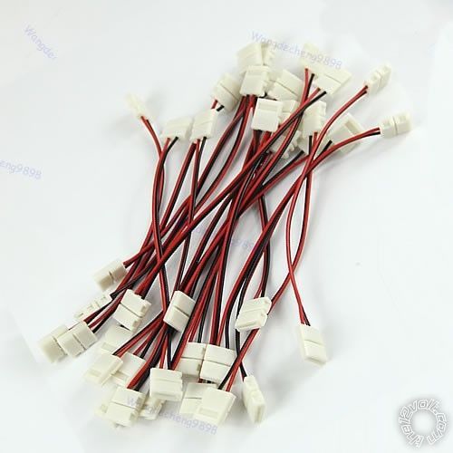

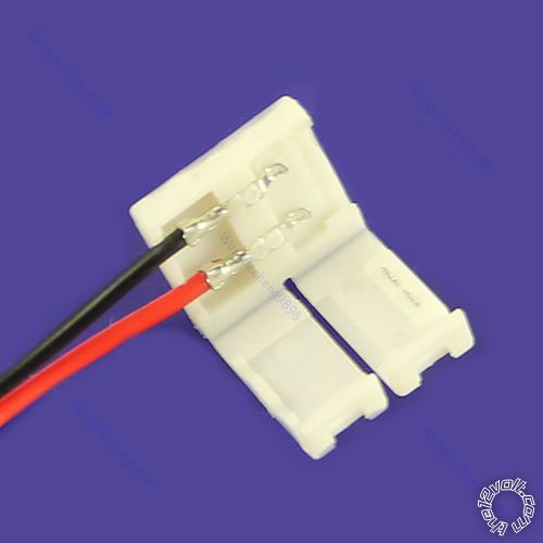

Mine are usually 2 pin as below. Typically 50c each in packs of 10 or more.
As you say, waterproofing is probably irrelevant.
what is the best source for led ribbons? - Last Post -- posted image.

1) I found very similar connectors to the ones you pictured on Amazon. They say they are 12V and 10 mm wide. Is this like the lights themselves, do I need to be concerned that an automotive application is higher than 12 volts? Do I need to find connectors that are rated higher?
2) The ribbon I'm looking at says it's 10.15 mm wide; I assume the 0.15 mm extra is okay for these connectors?

You MUST get the connector that suits your ribbon - hence width, track spacing, and number of conductors (2 for dumb & single color ribbons).
I think they vary with LED type - eg 3528, 5050, 5050-RGB etc - but I'm not certain.
I suspect the "12V" is merely a description rather than a rating. They probably handle at least 30V.
