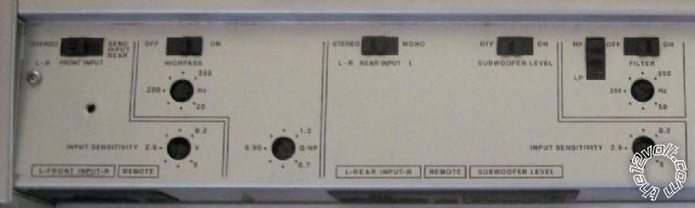

These are the controls on my amp. This is NOT a picture of how I have anything set, it's just a picture I saved from a google image search before I bought it. Oh, and I got it on ebay. That might be my problem right there! LOL!
is something blowing my speaker? - Last Post -- posted image.

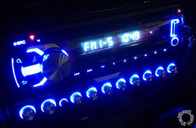

My head unit and equalizer in daylight:
Cool blue lights at night!
