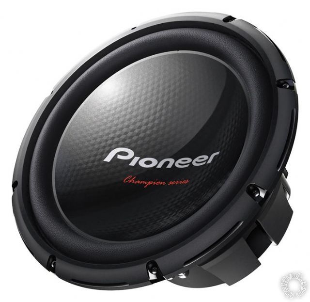

The subs I was considering were Pioneer Champion TS-W310D4 dvc 12's (those have the F/R of 20-250Hz) and the Pioneer Champion Pro TS-W3003D4 (with their F/R of 20-80Hz). Although the Pro's have a wee bit more power handling (600 wpc RMS, 2000 wpc max) over the regular Champion's (400 wpc RMS, 1400 wpc max), I've made up my mind: I am NOT getting the Pro's. Why? Well, I called Sonic Electronix and talked to a tech and he actually thought the 20-80Hz was a typo! He checked Pioneer's website and confirmed yes, that was the correct F/R. He quickly advised me against any sub with a F/R only going up to 80Hz if I wanted to hear any bass drums or bass guitar. Not only that, once he saw how much I've spent there over the last few years, he knocked $5 off each, making them $120 for the pair instead of $130.
So I'm ordering the ones with the frequency response of 20-250Hz because of expert opinion AND some of your replies. Oh, and because I can always adjust my crossovers to whatever max frequency I desire.

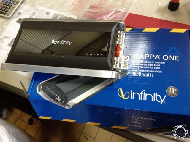

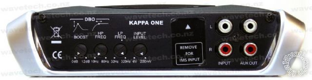

These two DVC 12's are going to be run in parellel/bridged mono powered by an Infinity Kappa One 1,600 watt (max) mono amp. I think I'll be happy with the bass. Not looking to rattle anyone's windows down the street, just want the bass to sound good without turning stuff way up.

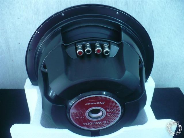

Thanks again for your replies! Pictures coming soon of the finished products, but here are what I'll be bumping with:
opinions, 12'' subs frequency response - Last Post -- posted image.

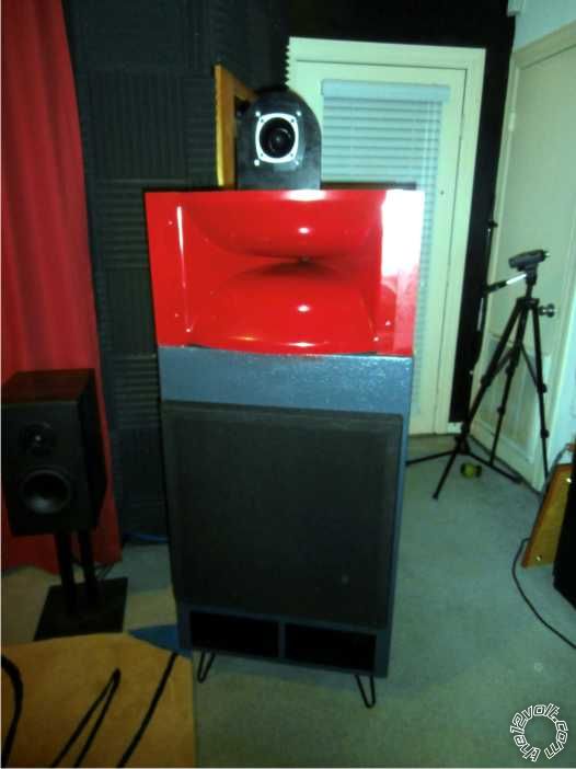

And by the way I just built a system for a friend using 18" subs crossed at 600Hz in a 2-way stereo system. Speakers are speakers and ALL of them will reproduce nearly the full range of human hearing: it's just that different designs are optimized for best performance over certain bands. But you can seriously do almost anything you want with them if you know how. :)

600Hz, what did you have to do to get the 18.s to blend with the mids up that high? or did the box design even allow much response up that high. i used to have a similar setup, one set of 2-way components up front and a single 18 crossed over at around 100Hz and my low tuned box created a natural roll off around 100 hz that blended well with my door speakers. ah... i miss that setup...

Well, I've already ordered and paid for my 12's, and stuck with the original plan of the ones that do 20-250Hz, then I'll just adjust my crossovers to keep the frequency down where I want it. My Clarion 6x9's go down to 25Hz, but I'm going to set my low-pass crossover switch on top of my equalizer to 90Hz and maybe tweak the Kappa ON's DBO variable high-pass filter to what the owner's manual suggests.

Here's the system:
18" pro audio Warfdale subwoofer in 4 cuft ported enclosure, passive crossover @600Hz to horn, and @11KHz to super tweet. Sounds fantastic. Measures flat to 26Hz.
