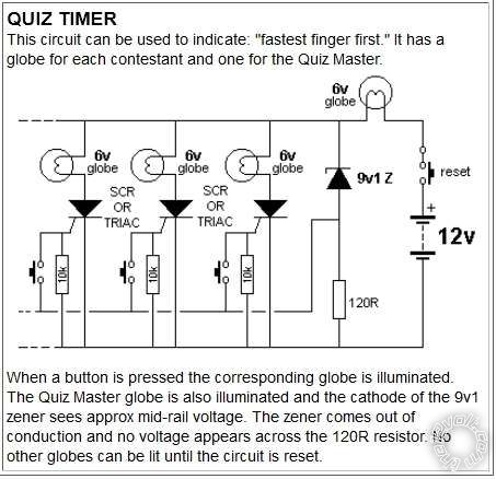

Google (two button) quiz circuits. I suggest viewing Images.
Maybe the simplest is from electronicdesignworks.com reflex action game; namely:
relays for game button circuit - Last Post -- posted image.
Usually they use SCRs as per the Quiz Timer circuit at zaleski.org's from 101-200 Transistor circuits.pdf - ie:

ok im confused about the last sentence he said..
"Similarly when S1 is pressed first, the lamp(L2) associated with S1 will glow preventing L1 to glow. Since, at a time only one lamp will glow, this circuit will always give correct judgment."
i thought it was when you pressed S1 the L1 will glow and it prevents the L2 to glow even if S2 is pressed?

S1 turns on T1 which illuminates L1.
T1 turning on raises p to a higher voltage (maybe 5V) hence if S2 is pressed, p is too far above 0V (GND) to turn on T2. T1 & T2 are PNP transistors which need their Base thru S1 & R2 or S2 & R1 to a reasonably more negative voltage than their Emitter (to +6V via S3) to turn on.
Maybe I'm wrong else he's confused the circuit sides, but either way, it should be easy to check during testing or swap leads after assembling.
