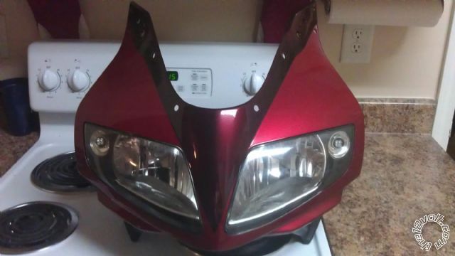

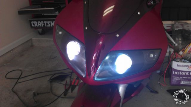

The result is better looking light color, and a defined cut off line, while making them look aggressive.

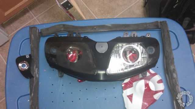

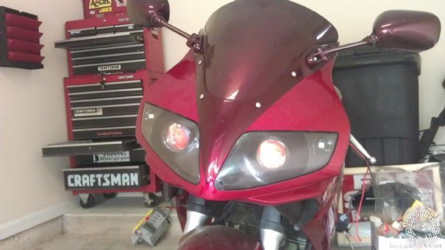

before(10HID's on factory reflectors) and after (6k with projectors).
headlight retrofit, how and why. - Last Post -- posted image.

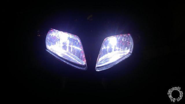

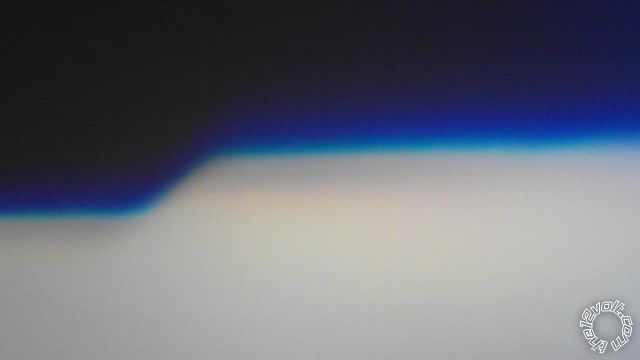

The purpose of the Cut off line is instead of light being reflected out of the headlamp in every direction (wasting light going in directions you dont need), it is focused were you need it. it also will not created glare that can blind other drivers. A silinoid can move the focus and physically bring it higher for "high beams". that being said the low beams produce an equal amount of light as the high beams, but dont "bright light" people since i have them aimed lower than the average mirror.
the color of the cutoff line is just because i think it looks cool.
factory lights (with 10k hid) on and off. (almost factory, i added the red LEDs a while ago, but they will be gone in the end) u can see the reflector in no way focuses the light beam

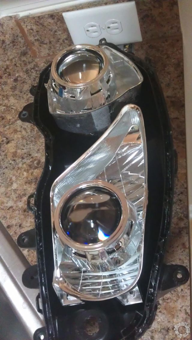

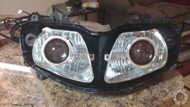

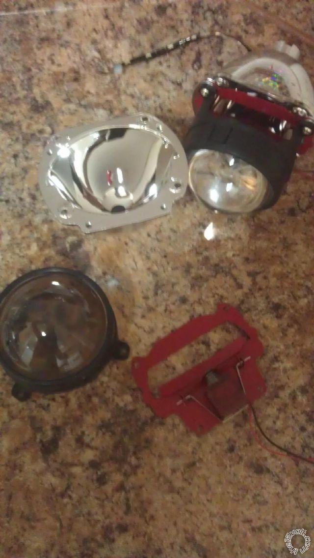

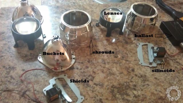

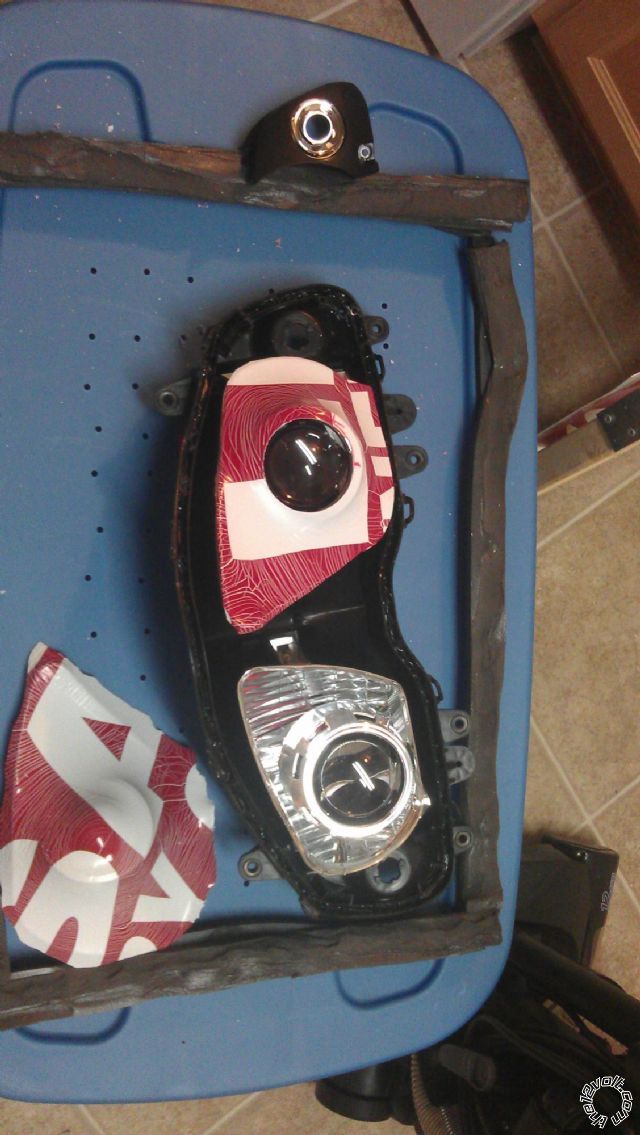

i added bi-xenon HID projector. that involves projector buckets, light shields (motorized by a silinoid), and lenses, shrouds, HID bulbs (6k for white color) and AC ballast to increase output from the bulbs. Shrouds just make it look nicer in the head lamp assembly.

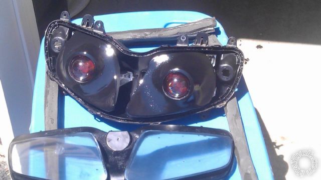

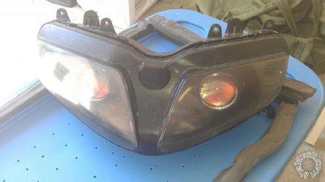

Painted the shields for looks. when you look at the light through the curved lenses, it warps your vision and makes the lens appear to be red, even though it is clear.

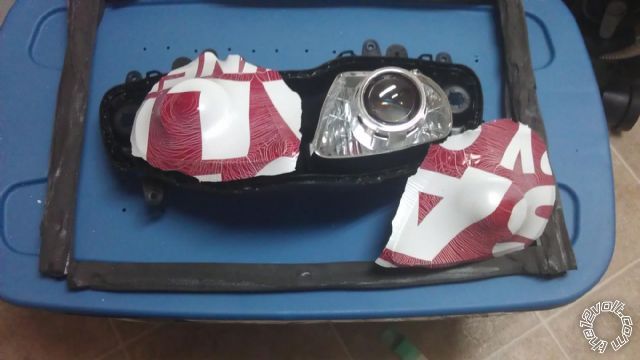

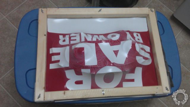

Since i didnt like the look i got some plastic (a for sale sign) heated it up in the oven, put the light on a homemade vacuum table and molded the plastic around the light. For future reference, dont use a for sale sign, it is not the right material.
Then timed it to fit
Then primed and painted. (in this picture u can see the red painted shields, making the lense look red).
now the projectors look built into the light not just mounted and floating there.

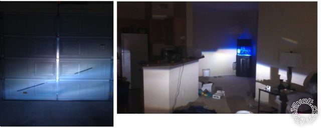

Since i mounted the projectors to the factory reflectors, the factory adjustments for aiming the lights still work. allowing me to line up the cut offs from each light right on top of each other, giving me a very defined line. It is also fully reversible if i ever wanted to, without having to buy any new parts. I doubt i ever will, but it is nice to know i can.

The hid retrofit into a halogen reflector is illegal, but I retrofit a hid projector to house the hid light, so it gets to a blurry part of the law, as my hid is in a hid projector inside a halogen reflector could go either way on that. Fingers crossed, and the vaccume mold housing makes it look factory enough I doubt many cops could tell the difference.

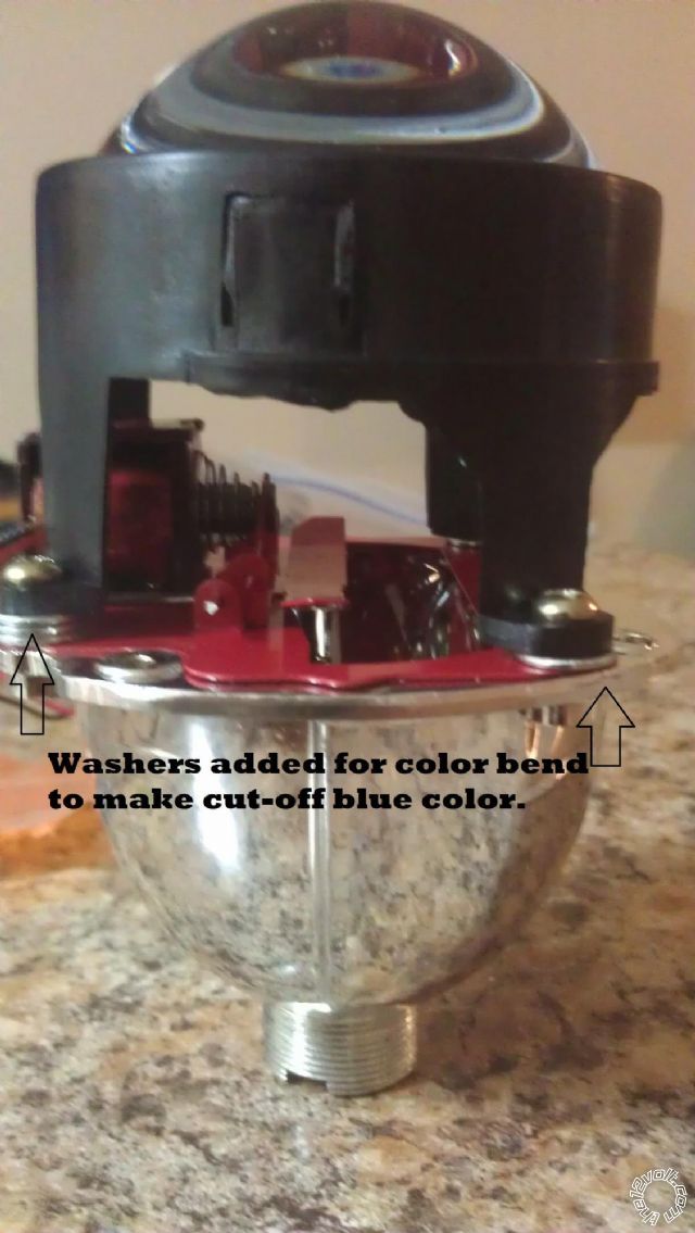

I do loose some light by creating the blue cut off line, but I really like the way it looks. And it is far less blue than all the 10k hids I see in my town, so I hope the police go bother those guys befor they bother with me has worked so far... fingers crossed.
As far as red lights on the front goes, I have none. The globe/lense looks red with the lights off due to painting the shield, but with the lights on, there is no red to bee seen. It is an optical illusion. Caused by the red shield behind o a curved glass lense.   U saw the output pic. No red light there either. Only looks red parked with the bike off. headlight retrofit, how and why. - Last Post -- posted image.

Ah!!! With thanks. Now I see the front red is not lighting headlight retrofit, how and why. - Last Post -- posted image.. How cool - a "light" that matches the color of the fairing. headlight retrofit, how and why. - Last Post -- posted image.
