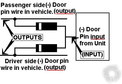

Here is the rear door pin isolation wiring using two 1N4004 diodes. If you were going W2W, you could add the FLCAN front door trigger output to this and input all three signal to the Vipers (-) Door Trigger input wire.
Viper 5706v install 2005 Silverado ex cab - Page 6 - Last Post -- posted image.
