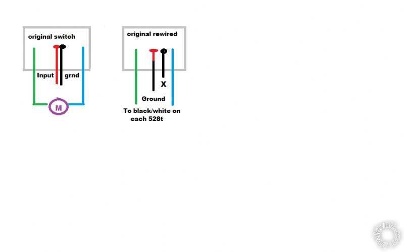

Here's a stylised diagram of how to rewire your existing switch, this makes it one touch either way. As I said before, this is how mirror folds and effectively one windows work.
Disconnect 12 V+ supply and rewire to the 528t's and ground (s), reconnect ground to 12V+ terminal, send outputs (originally to motor) to each 528t.:-

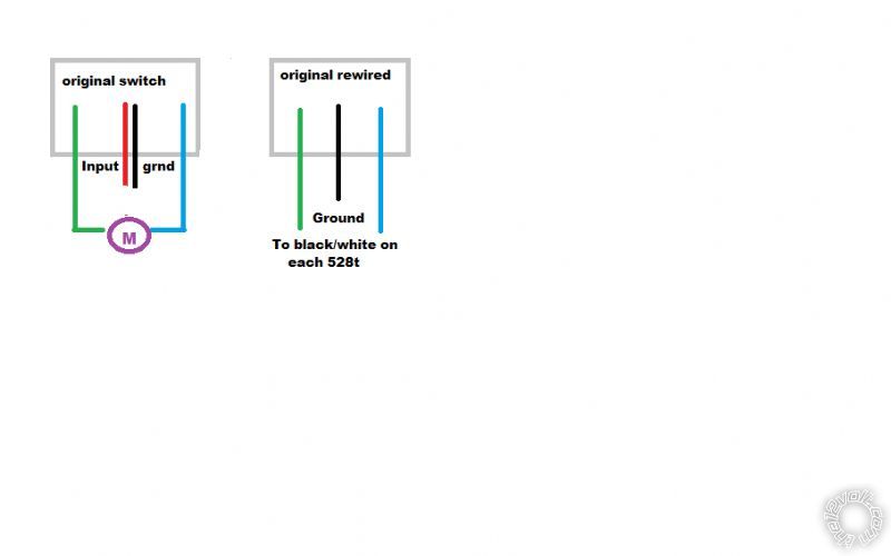

Posted: April 03, 2015 at 11:54 AM / IP Logged Link to Post Post Reply Quote howie ll
I've redone that diagram to make what you have to do more obvious:- 2EF_switch_mods.png
