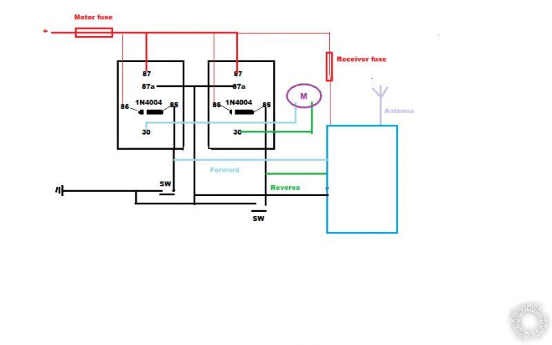

This is my 1st post to this very informative forum so I ask for your indulgence as I am a total novice to 12 volt wiring.
I have built a trailer dolly powered by a 12 volt DC 600 watt motor through 2 x 5-pin Tyco V23134-A1052-C643 relays (30, 85, 86, 87, and 87a) to control forward and reverse of the motor through 2 momentary switches.
(the electrics were done by a friend who is now unavailable)
I would like to connect a remote control receiver to this setup.
The receiver has 5 wires - 1 x positive, 1 x negative, 1 x fwd, 1 x rev, 1 x antenna.
QUESTION:
How do I connect the remote receiver to this setup?
Hope you can help.

Go to this page:- https://www.the12volt.com/doorlocks/page3.asp#4w
and look at the diagram actuators reverse polarity.
Lock and unlock = your forward and reverse
actuators = your motor.
This assumes that the forward and reverse wires on your receiver are (-) NEG.
TEST.
Posted: April 25, 2015 at 6:38 AM / IP Logged Link to Post Post Reply Quote howie ll
If so wire from the output of the switches to relay 85.
I've just done a better diagram for you, note the quenching diodes, 1N4004, they protect your receiver.

Posted: April 28, 2015 at 8:08 PM / IP Logged Link to Post Post Reply Quote hotwaterwizard
Looks like it will do the job to me.Remote control Receiver to 2 x relays - Last Post -- posted image.
