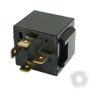

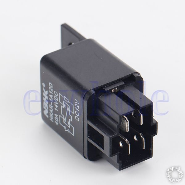

Hello all. I am having some relay issues. I just installed some fog lights from a Honda Inspire to my Acura TL. Everything worked fine for a week and then the lights wont come on. So I checked under the hood and when I flip the fog light switch, the relay makes a quick buzz sound for like 4 seconds and then cuts out. But the lights do not come on. So I purchased another relay and the same problem occurred. So I figure its worth purchasing an auxiliary add on relay from autozone but they are shaped differently.
So, on to my request. Here is a pick of the relay that I have. Can anyone tell me which pin is 85, 86, 87, etc. This way I can convert the wires to match the new relay.
Thanks!

Ground 85, apply power from the battery to pin 30 via a fuse at the battery. Connect 87 to the fog lights. Ground the fog lights. Anytime there is power on 86 the relay will energize and turn the lights on.
