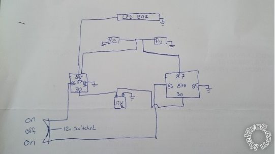

Hi, I have a LED light bar installed on my truck that works just fine. Now I want to install fog lights, I have a On-off-on rocker switch and would like it to work so that I can have both the Light bar and Fog lights on or just the fog lights. I have 2 relays one has 2 87 pins on it and the other is just a regular 4 pin. The problem I am having is how do I make this work without back feeding to the light bar. I have included a picture, hope this helps!

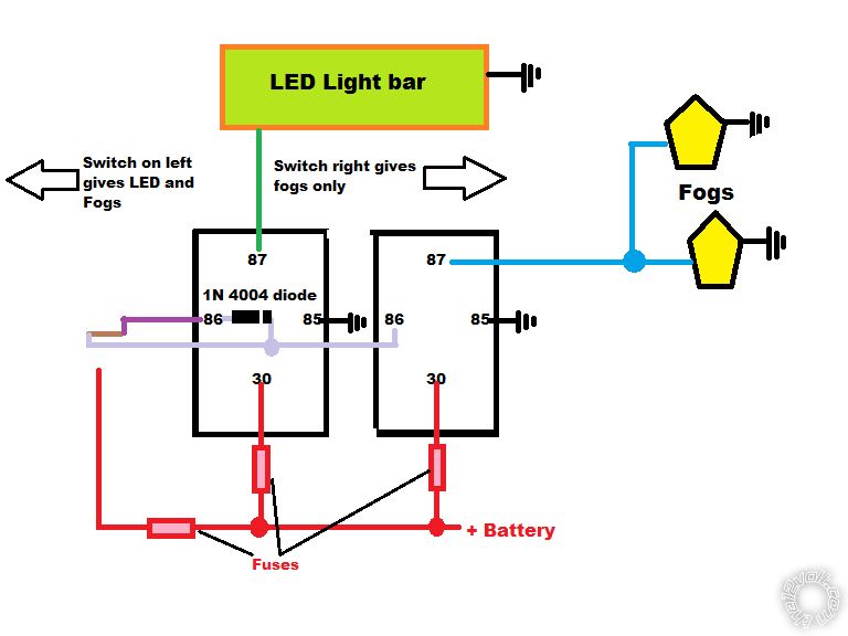

Posted: September 03, 2015 at 6:13 PM / IP Logged Link to Post Post Reply Quote howie ll
You just need to add a diode (1N4004).
For simplicity sake I've ignored 87a, not used anyway.

Are these automotive diodes or regular ones? also silly question how would one install it in line with automotive wire?
Posted: September 03, 2015 at 6:54 PM / IP Logged Link to Post Post Reply Quote howie ll
All the same, the most commonly available diode.
Solder.

Rock on, Thanks for the help. Ill give it a shot!
