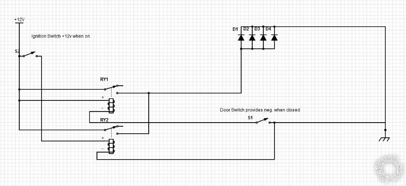

two relays.
one triggered by the door ground that has constant hot.
The other triggered by ignition that has constant ground.
use both to send voltage to the LED's
Power LEDs from both 12v constant and ignition - Last Post -- posted image.

If you dont want to use the relay on the ignition side, you might be able to get away with a diode. but the reason for the second relay is to prevent the door activation from sending power back to your switched ignition circuit. (not cool when you open your doors and the stereo turns on....)
