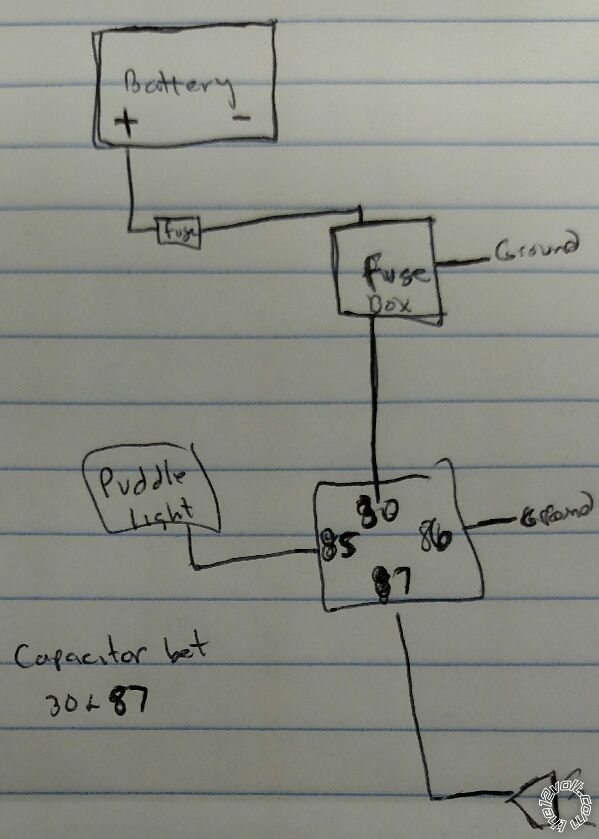

So after doing much reading I have decided to just go ahead and redo the wiring for the additional lights. I do have a few questions so any help is appreciated. Here is my plan:
Add fuse box, run fused power wire from battery to fuse box
Run power from fuse box to relay and then to additional lights
Use puddle light wire as switch on relay
Add capacitor and diode to handle any buzzing from fade out
The questions I have are:
Can I attach all of the leds to just one relay or do I need one for driver side and one for passenger side?
Where would the diode be wired?
How exactly do I connect the capacitor? Is it soldered to the relay?
I will try to post a diagram but this is all new to me so it might be a very crude drawing.

Posted: June 29, 2016 at 12:20 PM / IP Logged Link to Post Post Reply Quote subprime
Here is my attempt at a diagram. I'd like to wire 2 led strips and one projector puddle to the relay. Also don't know where the diode would go.

Posted: July 13, 2016 at 8:12 AM / IP Logged Link to Post Post Reply Quote subprime
Just to confirm that I wired the lights this way and everything appears to be working fine.
