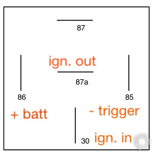

I need to deactivate an ignition 12v feed with a negative input. In the absence of this negative input, I need for the circuit to operate normally. Any help would be greatly appreciated.

Here
12v deactivation with negative input - Last Post -- posted image.

BTW that should only be momentary, if it's on constantly it will drain your battery, if you intend using it as an immobiliser I suggest making terminal 86 IGN rather than battery.
