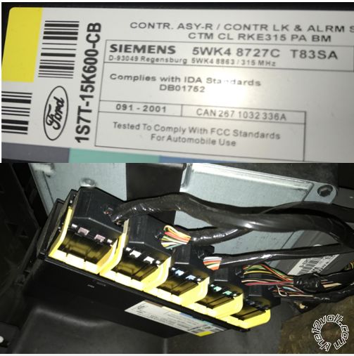

Posted: January 02, 2017 at 11:12 AM / IP Logged Link to Post Post Reply Quote bozb41
kreg357, I found out new information. I don't believe the wires are in the drivers kick panel. In the passenger side behind the glove box I found a module installed that says "contr.asy-R / Contr LK and ALRM system". I believe wires I need must be somewhere in one of these 5 harnesses. If you or someone else could give me any information on how to wire in this keyless entry module now that I found this I would greatly appreciate it. Thank you!

Posted: January 08, 2017 at 2:43 PM / IP Logged Link to Post Post Reply Quote bozb41
Installed a aftermarket keyless on my sons car, (2002 Focus) thanks to some on this sight for helping me with that. Here's the deal. It works "sometimes". When it's working it works perfect. After a few hours it won't work anymore until we push the unlock button a dozen times or stick the key in the door and unlock it, then it starts working again. I believe the transmitter and receiver are fine. I'm going to double check but I believe I can hear the receiver fire the relay every time I push lock/unlock but the car locks don't move. Then it will suddenly start to work. Is there a possibility the car factory security is interfering with the aftermarket keyless? I'm sure it's wired correctly and I believe the grounding point is fine as well. Please help. Thanks.
rmotlyintrested
Member - Posts: 35
Joined: August 15, 2016
Location: Manitoba, Canada
Posted: January 08, 2017 at 10:02 PM / IP Logged Link to Post Post Reply Quote rmotlyintrested
You could try searching "Gem module goes to sleep" on this site. The BCM (AKA Gem, I believe) sometimes goes to sleep after periods of inactivity. This could result in the symptoms you are experiencing. If you search you may find some possible solutions or work-arounds to this problem. Worth a look.
