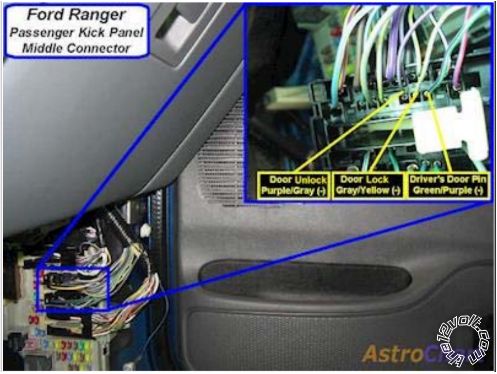

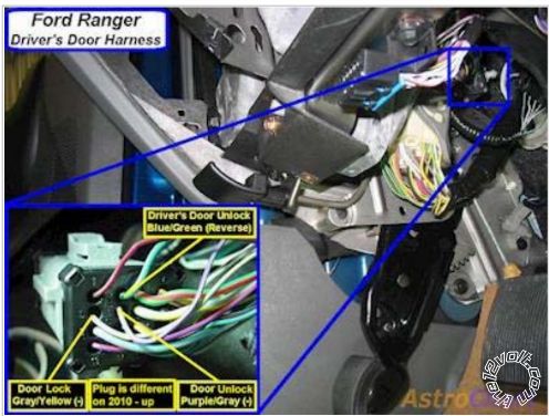

sorry, thought you had a F150, not a ranger.. Gray / YELLOW (lock) and PURPLE / gray(unlock) in a black plug just behind the obd connector

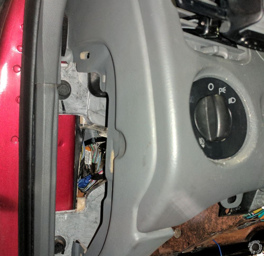

This is what & where I connected the "BROWN (–) Lock output" & "GREEN (–) Unlock output"
Prostart CT-4211TW & DBALL2, 2008 Ford Ranger - Last Post -- posted image.
This is what was suggested by silvercivicsir above by email. However it is impossible to reach.
Here is a picture of where it is located in my truck! behind the light switch!
