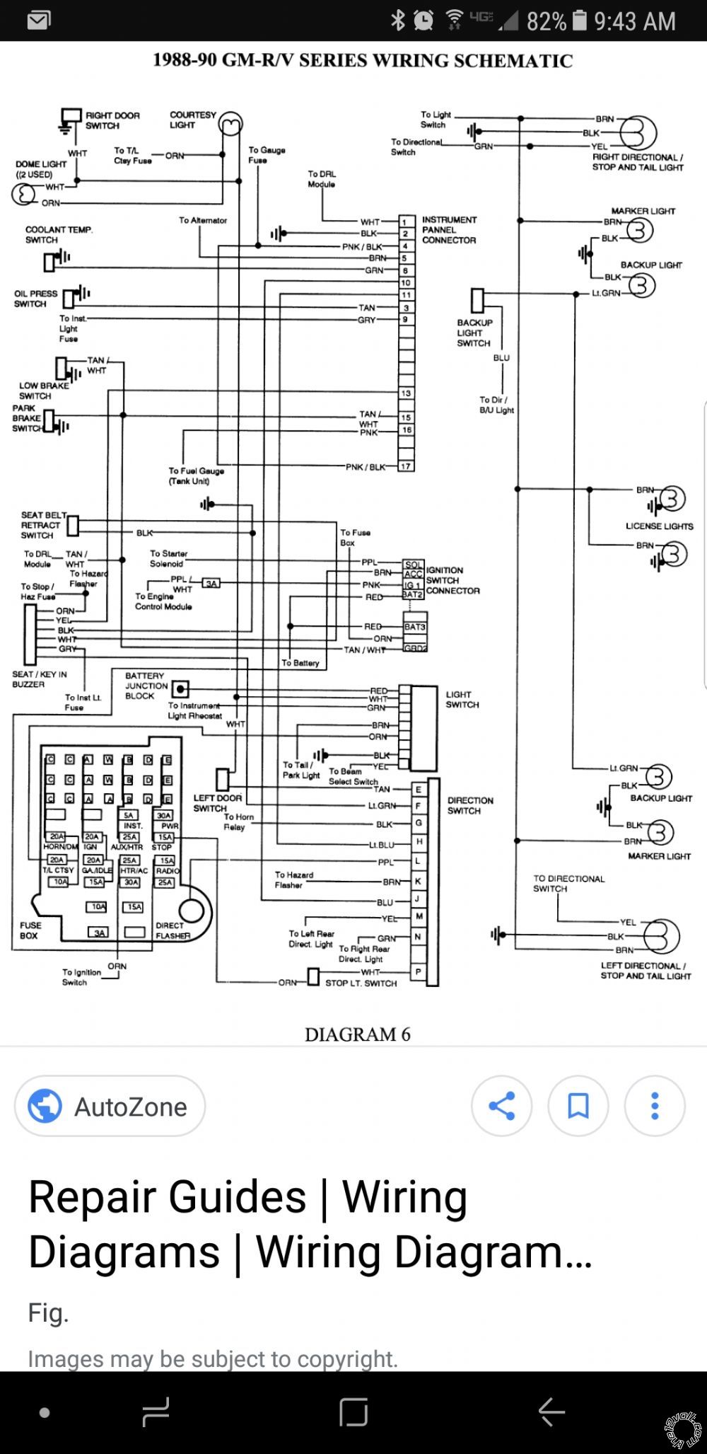

According to this it's all the same. That's why I don't understand why opening door would trigger the flashers.
1989 Suburban Open Door Triggers Flasher - Last Post -- posted image.
