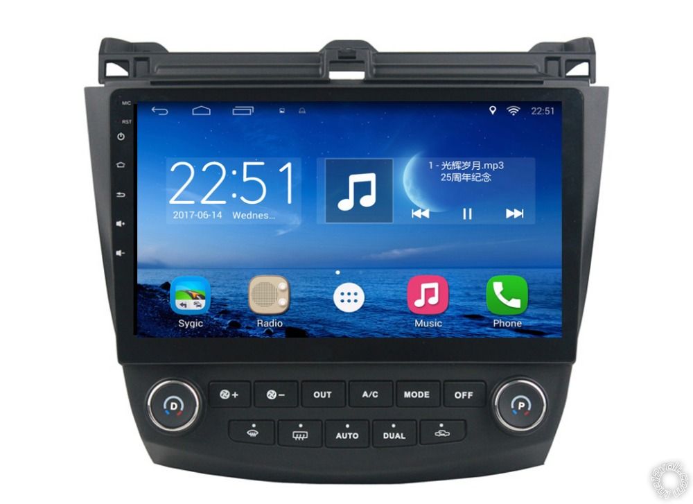

After going through four factory radios in the last two years (in two cars), I've decided to buy this one from AliExpress. After 2 months of waiting, finally I received it. There are couple issues with it, but the main one is that I've received a DUAL zone unit, instead of a SINGLE one. I've checked with the manufacturer before I bought it, and he assured me that this unit would work. The radio works, but none of AC/heat buttons works. I've done some research online, and I have a question - is it just a matter or rearranging wires in a plug? Or is there more to it? Since I have this radio, I've decided to play with it.

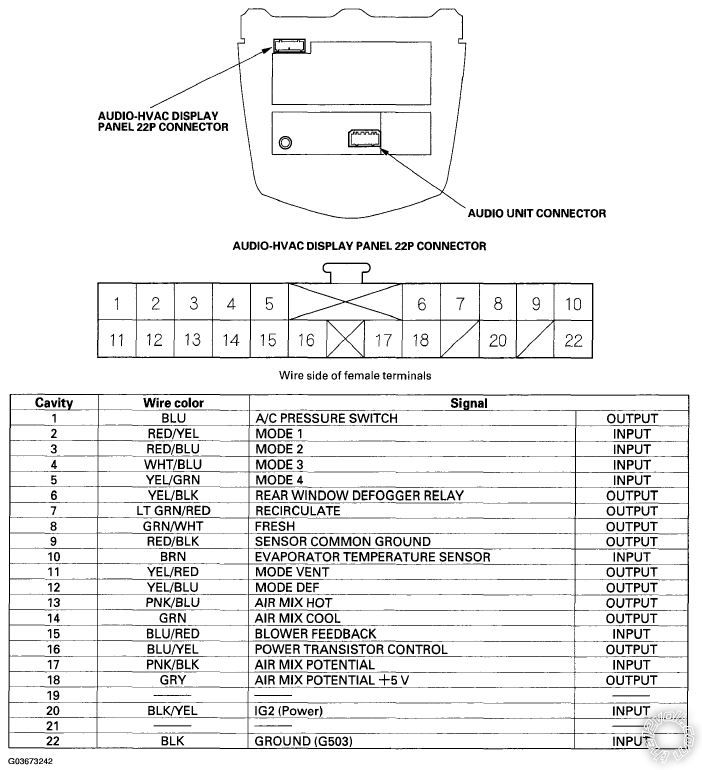

So, I've found this list for my, single zone HVAC unit:
7th Gen Honda Accord Radio Chinese, AC - Last Post -- posted image.

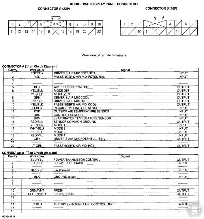

...and also for dual zone HVAC (the Chinese radio in this case):

This radio has been a BIG disappointment, even though it looked very promising. The reason I bought it was, that I wanted an android unit. In addition to the FM/AM radio (offering some entertainment on my daily commute), it was supposed to have a gps, wifi, bluetooth, be able to play audio/video files, even support steering wheel controls and 4G network (no CD player though)… All the latest bells and whistles… I also wanted to connect a backup camera (already purchased), dashcam, Bluetooth OBD2 and tpms… what a disappointment… I’ve found another seller on Aliexpress, who claims his unit is universal - for single AND dual zone HVAC… I’m not falling for that again… My advice to you is: DO NOT BUY.
