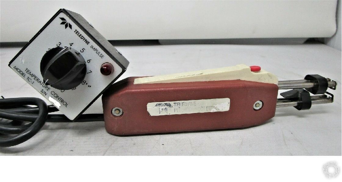

Just a tip / personal preference on my part. Considering how thin gauge the wires are in the newer vehicles, I purchased a used Teledyne StripAll Model TWC-1. New units go for $400 plus but used ones can be found for under $100. They use a pair of heated blades to melt through the wire insulation without cutting or even nicking the stranded wires. While they are meant to remove the insulation from a cut end of wire, they can be used in the middle of a length of wire. You will notice the bunched insulation on the stripped wires in this pictorial. There is an adjustable thermostat to set the blade temperature. This comes in handy for the different types of insulation material ( plastic, rubber, Teflon, etc ). The only downside is the length of the stripper arms and the width of the body. Getting in to tight places is not impossible but does take patience. Picture below :
