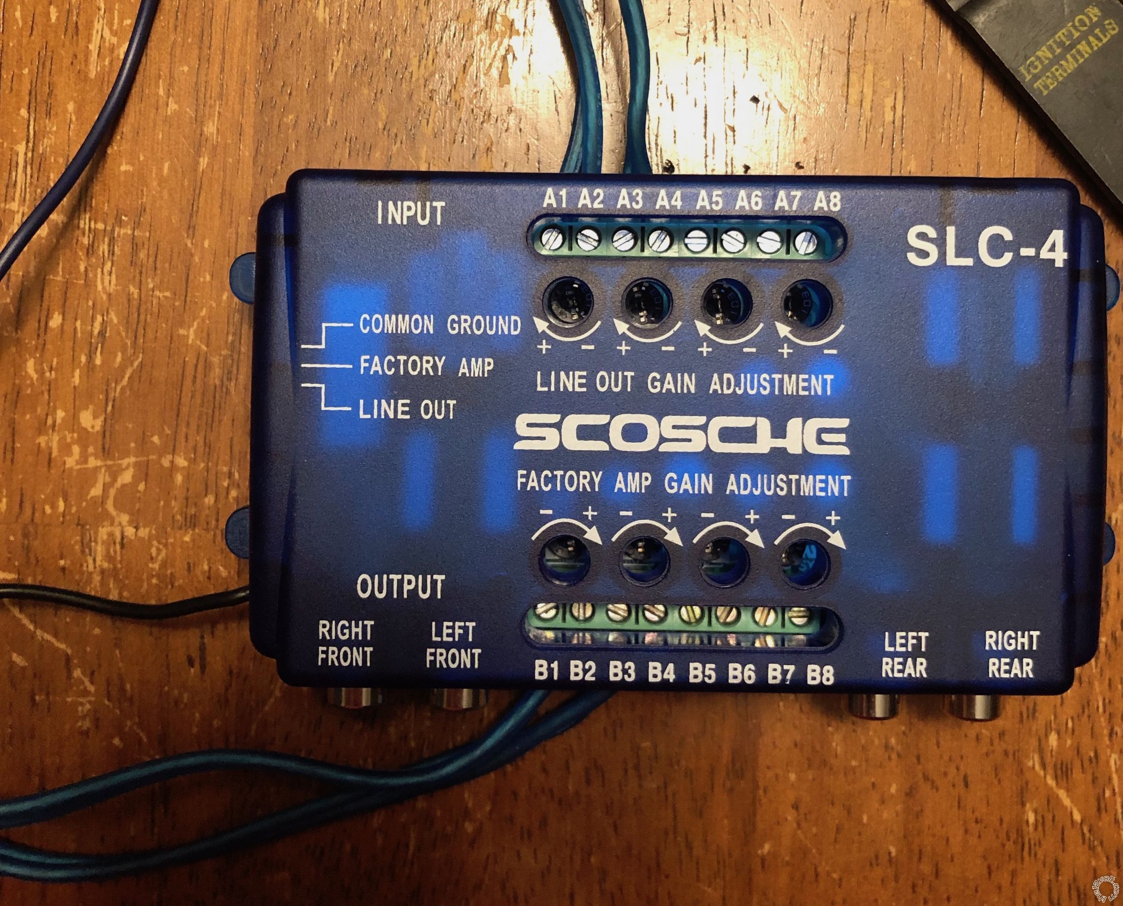

I know how to hook it up (or so, I Know how the Crutchfield guy told me to) - here is my question... How does this thing work? To me, all logic indicates that it simply lowers the line level of my Head unit (amp) and then uses the BOSE amp. Well, this is exactly the opposite of what I want to be done. I am told this is not what is happening, but it seems to me that if I connect speaker wires from radio into the Scosche and then wires out to the BOSE... and then adjust the levels of the input wires from my radio... well... logic says I'm adjusting my stereo output.
Please explain to mo how this is bypassing the BOSE amp.
Also, do I select Common ground or Factory AMP (on the side)
Any clarification on this will be appreciated. I hate not knowing how something works - especially when it doesn't sound like it should be working the way I am told it should.

My apologies.
I have my own after market speakers.
So...
Powered head unit- scosche - Bose Amp - speakers.
I’ve been told the scosche bypasses the Bose amp
I tried to find the photo requirements - I only remembered the 5M limit. If I made it too big, I apologize and will reupload.
Scosche SLC-4, 1999 Mazda Miata - Last Post -- posted image.

That's not a bypass, just a line output converter.

Yes. I've watched that before, but I will watch it again.
So, it DOES do what I think it does, right? It lowers the level of power my head unit is putting out, and thus my BOSE amp is doing the amplification; not my head unit?

Yes.

This is what I learned:
  1. The Scosche does NOT bypass the factory amp.
  2. The Scosche lowers the level of my head unit's amp (means I'm not using it)
  3. I really need to physically bypass the amp
  4. Physically bypassing the amp will be a fun challenge
I'll let you know how it turns out.
