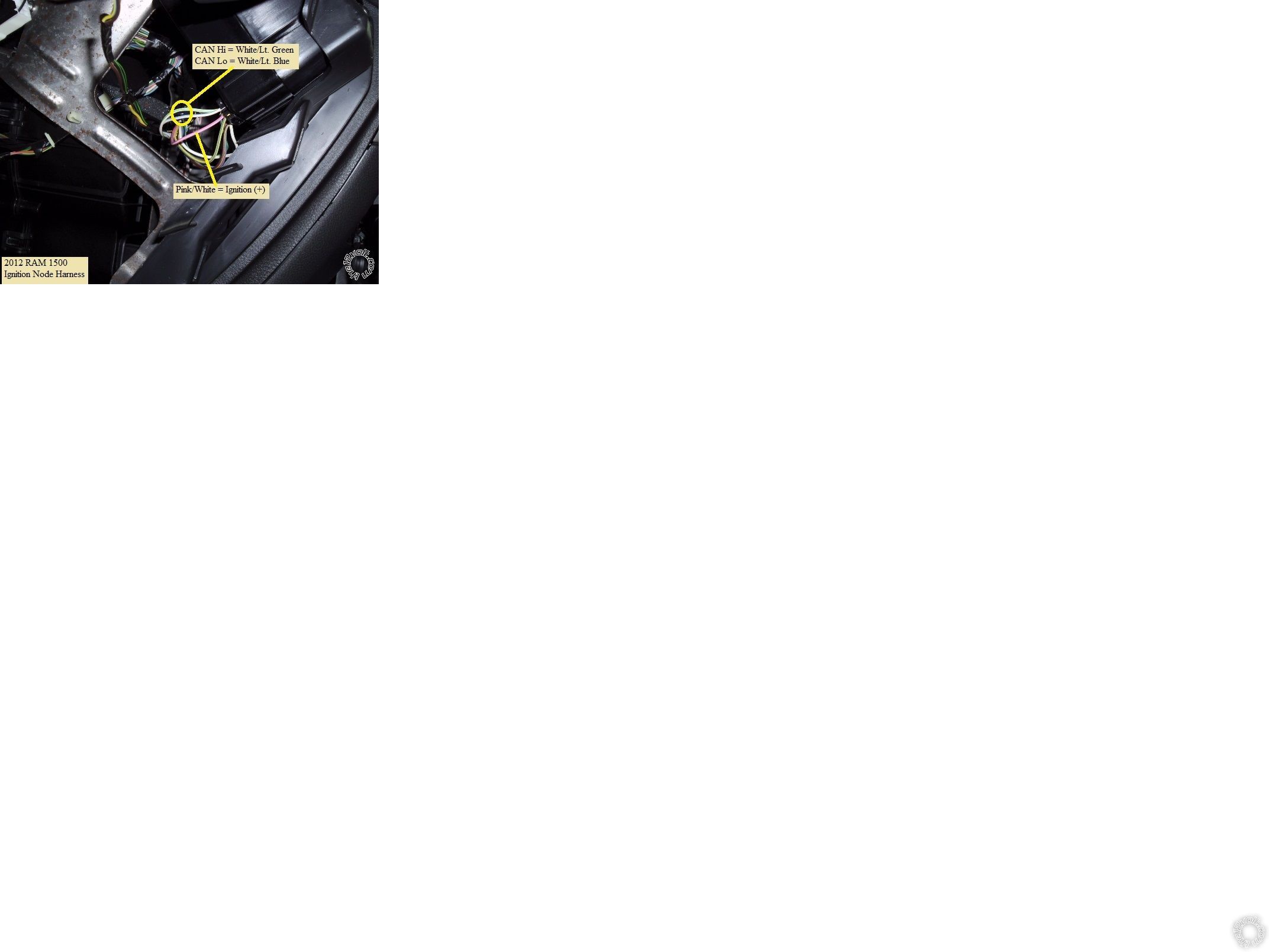

According to the ADS CH4 install guide, those 2 CAN wires can be found at the
300's Ignition Node 12 Pin Plug. The CAN High wire is White/Black at Pin 5 and
the CAN Low wire is White/Light Blue at Pin 6. Below is a photo of an ignition
node plug and harness from Dodge RAM that is similar.
2008 Chrysler 300, Prestige APS787E - Page 2 - Last Post -- posted image.

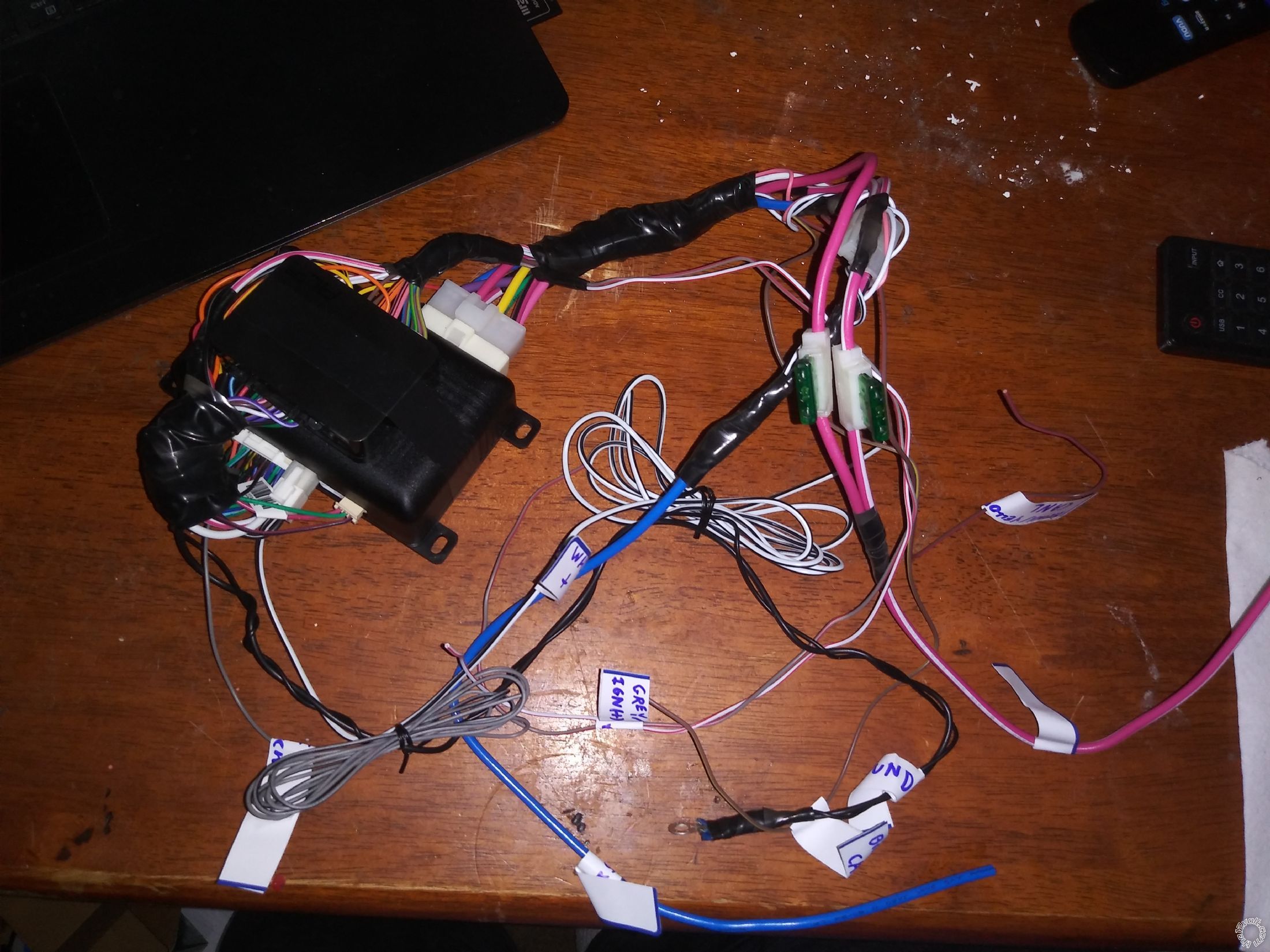

Here is my prepped alarm wiring. I cant install in the car until this weather gets better though.
