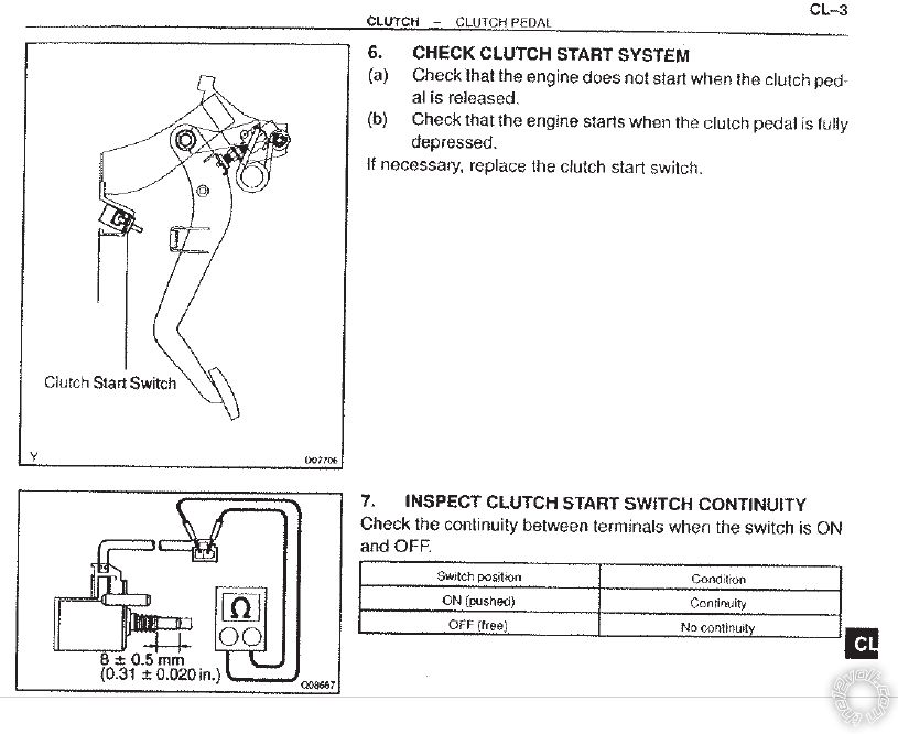

Seems like black yellow is for cruise control. I found black/white & white/black which seems like it's for clutch. When I manually join the 2 wires together it starts without pressing the clutch so I wired in relay to basically join them together and still doesn't start. Not sure what else to do with this thing anymore.
geepherder
Platinum - Posts: 3,668
Joined: October 27, 2003
Posted: October 26, 2019 at 4:58 AM / IP Logged Link to Post Post Reply Quote geepherder
How is your relay wired?

So i figured it out, apparently just a regular negative start or GWA from remote start is not enough so i had to change the polarity using relay and trigger it with positive start wire from remote start and BOOM! it works! It was actually Black/White wire at the clutch.
Thank You for all the help!
