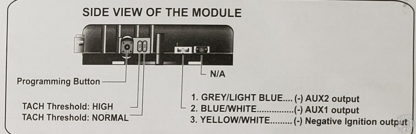

Are you talking about this 3 pin?
BMW E39 Remote Starter Wiring Confusion - Page 3 - Last Post -- posted image.
What's my connection setup with the relay. Do I put terminals 30 and 87a between the ignition wire going to the ignition switch, use yellow/white wire for ground and tap another ignition wire for positive?

For the third ignition wire, yes, that negative wire in the 3 pin harness will go to 85 of a relay. 86 and 30 will connect to a constant 12 volt positive source. 87 (not 87A) will connect to the third ignition wire.

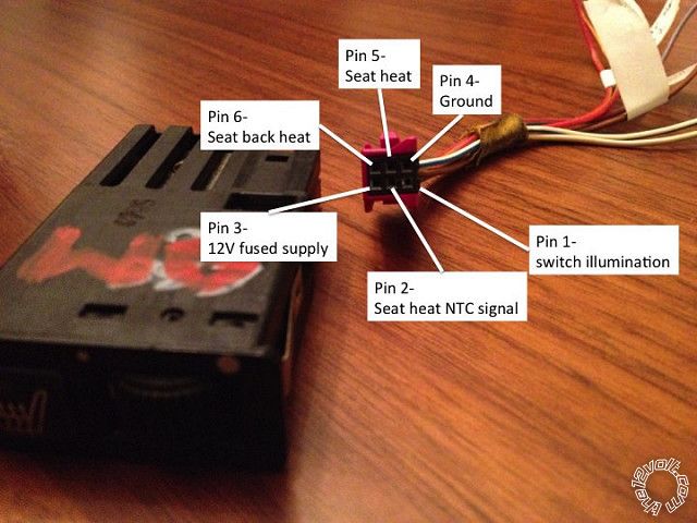

I took my panel apart and cut off the connector with the switch to test it.
Not quite sure how it works though.
I tried testing resistance between all the wires while pressing the button but wasn't able to figure out which wires activate the button.
I found this picture online
Everything is the same on my connector except mine doesnt have rear heated seats.
Once I removed the connector, I used 12 volts wall charger to supply pin 3 with power, and the light on the button came on.
So I'm thinking that when I press the button in my car, the circuit closes and the seats are heated for some time. After a while they're programmed to turn off so the power gets shut off.
I figure in this case I simply need to provide continuous power to pin 3 and it would activate the heating.
I'm not sure what pin 2 is for.
But I would've expected to have unlimited resistance between ground and power wires that went to 0 once I pressed the button.
If I can't figure it out, maybe I would connect directly to the heater connector under the seat and add an extra switch to turn it off once I'm inside the car after in warmed up.

Rather than testing for resistance with it disconnected from the vehicle, I'd test for voltage in the vehicle while it's powered on. Backprobe each wire and test from a known reference (either ground or 12 volts positive).
Get a baseline without any buttons pressed, and make note of your readings. Then test while pressing a button. Repeat this for remaining buttons if you have more than one.

Good thinking! This worked.
I connected multimeter negative probe to the ground wire on the connector and then tested all the wires with button off and on.
The only difference was on pin 5 wire (heat seat).
It went from 0 to 12 volts.
Now pin #3 always had 12 volts and 2 other pins had 3.5 and 5 volts.
So I guess when I press the button, 12 volts from pin 3 get transferred to pin 5.
Maybe I can put a relay in between pin 3 and pin 5 and activate it by wire 10 from my remote or by negative ignition output?
I'm trying to think of a way that I can still use the button to turn off/on the seat heat.

When you release the button, does pin 5 go back to 0 volts, or does it stay at 12 volts? This will tell you whether you need a momentary or a latched output from the remote start unit.
In order to connect pins 3 and 5, one will connect to 87 and the other to 30. 12 volts constant connects to 86 and 85 to your negative aux output. Be sure to program accordingly (pulsed or latched).

When I click it once, it lights up and stays on with 12 volts. If I press it again, it turns off and goes to 0 volts. Actually I'm not even sure if it turns off automatically or not, I can't remember.
I'm actually not sure if that means I should program it as latched or pulsed. I guess latched so that the relay closes and the supply of power is continuous.
I figure I can take constant 12 volts from pim 3 wire?
