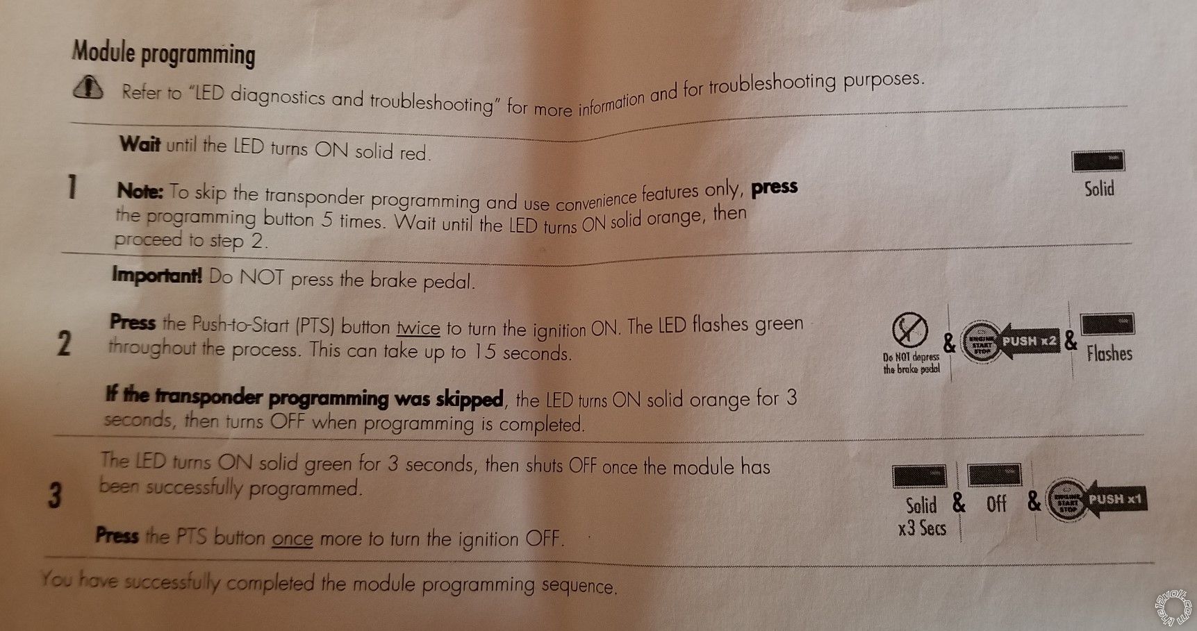

Kreg,
I verified the wiring and everything looks good, I initially thought that I had used the heavy gage wires for the ones that have the diode but that was not the case. I verified the wiring and everything looks correct. I remember that the module did not flash the green light, is there a way to restart the programming side without flashing it to be able to follow the module programming again? I don't have access to reflash as the seller did that for me when he sold the unit to me. If I reset the DB3 module (if possible) will it loose the flash to the car? I think this is a flashing issue at this point, door lock/unlock and trunk release work, the only thing that is not working is the remote start, it looks like it tries to start, activates the accessories, the module receives the signal, flashes orange and red momentarily and then flashes green for maybe 5 seconds and then turns off.
The sequence of DB3 flashes when remote start button is pressed:
1. 3x green flahes.
2. 3x yellow and red flashes (interchangeably)
3. Multiple green rapid flashes, then goes back to green slow flashing and tries again 3 more times before it stops. In the process of the rapid flashes I get the I-Key System Error: See Owner's Manual.
The vehicle does not crank at all.
Here is the module programming instruction. 2015 Nissan Altima PTS, Viper 4806V 2-Way - Page 2 - Last Post -- posted image.

Posted: October 03, 2020 at 3:53 PM / IP Logged Link to Post Post Reply Quote kreg357
Unfortunately, I'm not a DEI guy but you can do a "Soft Reset" as shown at the top of Page 15. This will get the DB3 ready to start the vehicle programming process again from the beginning. It will not affect the 403.NISS08 Ver 1.20 firmware loaded on the module.

Did not come back to confirm but after this was wired up accordingly, the programming sequence was executed and the car remote started fine.
