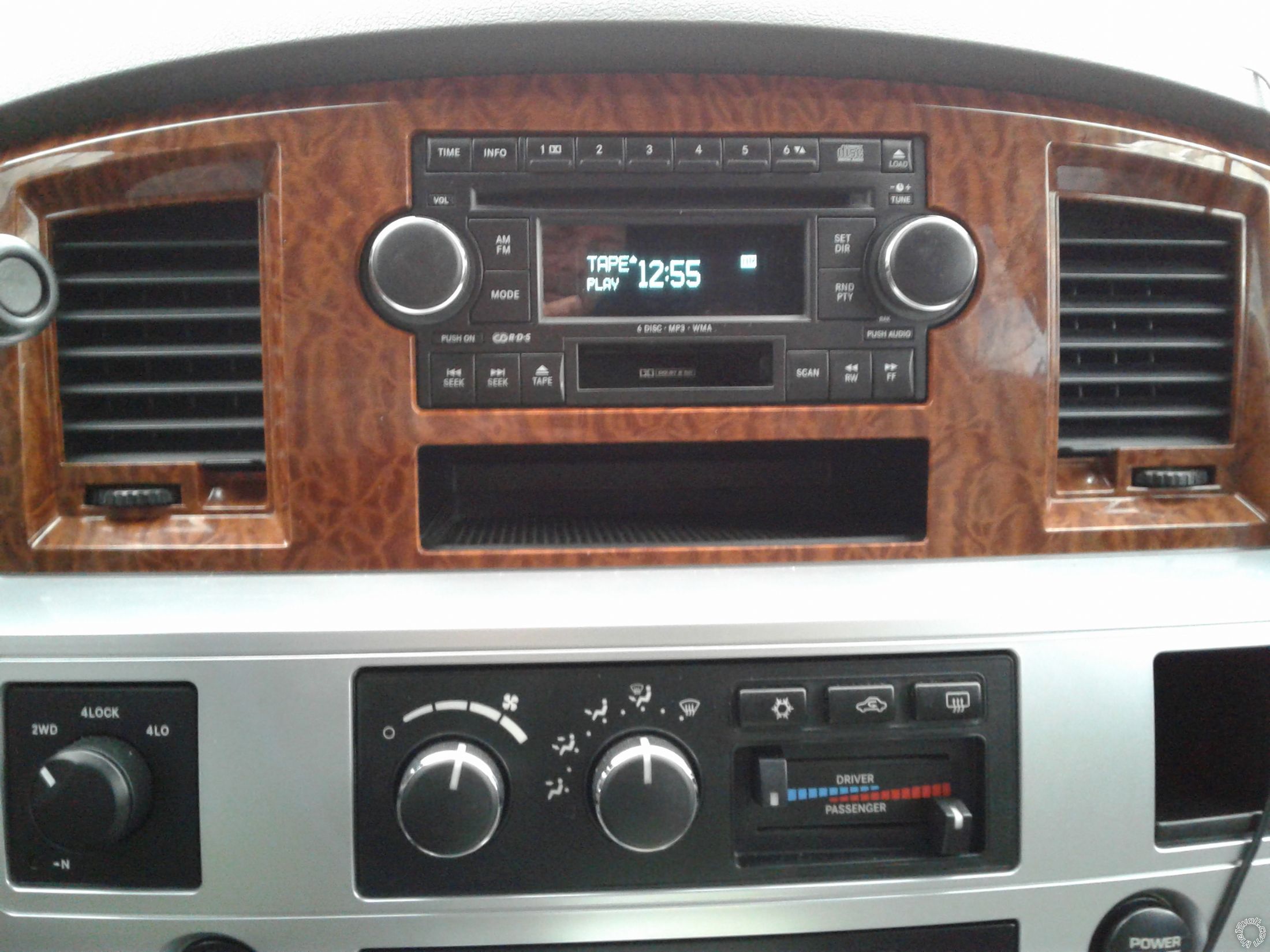

Posted: February 15, 2020 at 6:00 PM / IP Logged Link to Post Post Reply Quote aussie ford
This is what success looks like.
2006 Dodge Ram RAQ for RAK Radio Swap - Last Post -- posted image.
