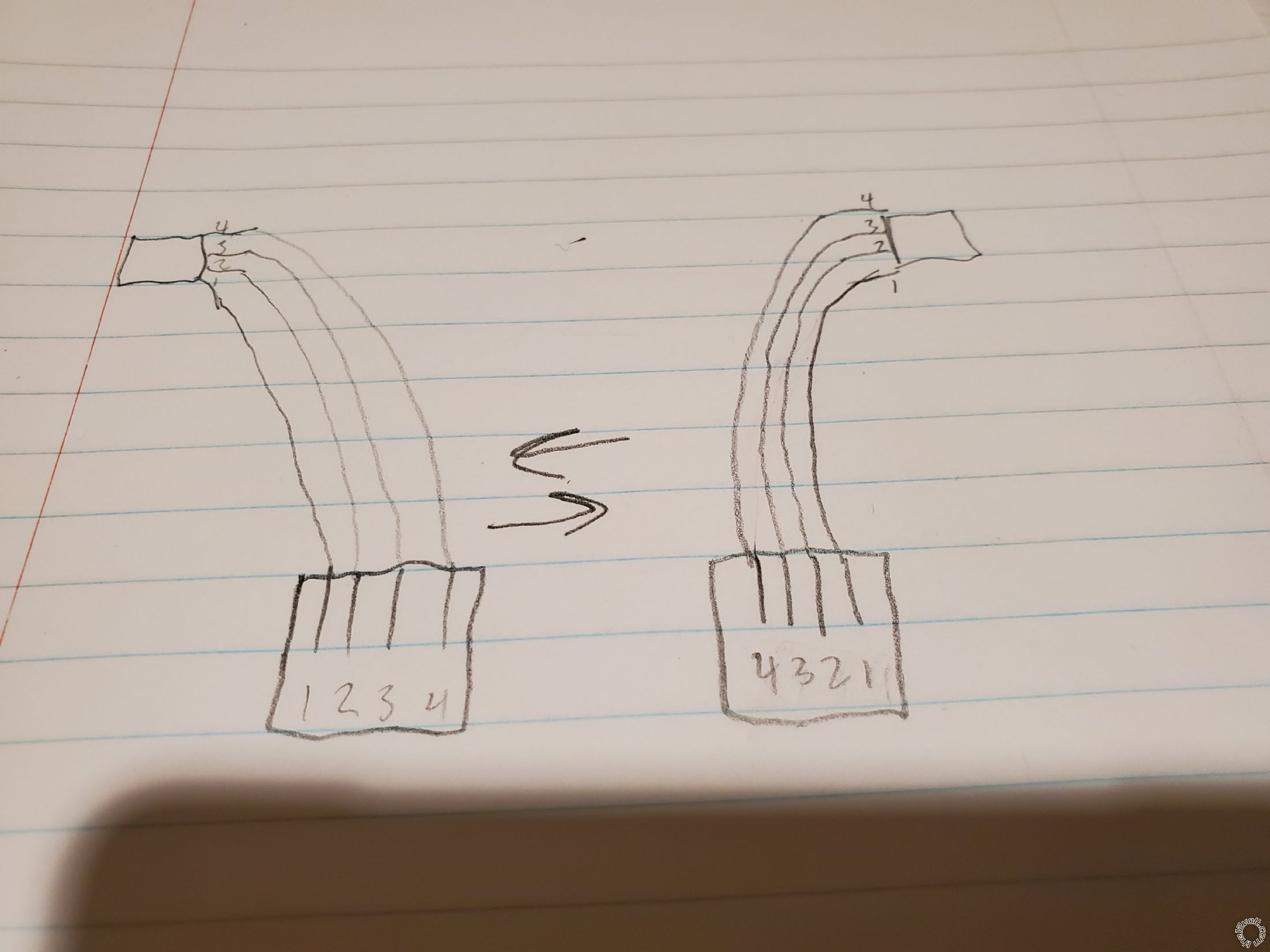

I am trying to figure out a way to swap a 4 wire plug to another 4 wire plug and the same with another at the same time. Kind of a flip flop. See the diagram and let me know if the is possible. Thanks! 4 Wire Switch Swap - Last Post -- posted image.

I'll try to get some pictures tonight. This is for the electric throttle on a jetski and the IBR. My wife likes them swapped because she broke her wrist but I prefer the standard setup. I can physically swap the plug connections but I'm trying to see if there is a way to swap the 2 connections with a switch of some sort. This would not be on the fly and be stored inside the hull so the engine would be off when switching. From the engine there is a 4 wire plug that goes to the throttle and one that goes to the IBR..if that helps explain my drawing.

So you basically need to swap 8 wires (or less if there are common grounds or 12V going to the 2 controls).
an 8 pole double throw switches could do the job. Does it need tp be water resistant?
Something like this (but possibly needing to be water resistant)
