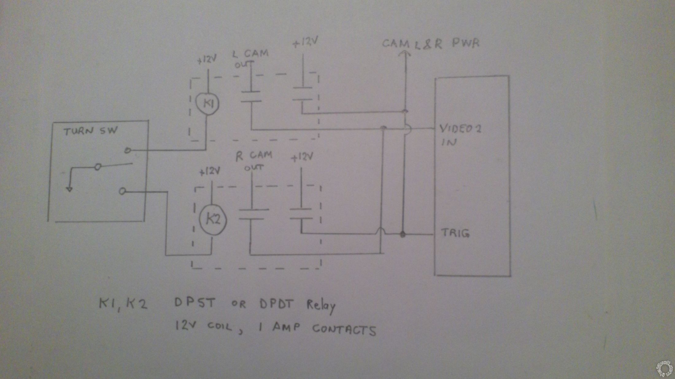

You can use 2 small DPST or DPDT relays as per photo.
Don't go oversize on the relay contact current ratings as they don't handle video signals very well.Two Triggers, One Output - Page 2 - Last Post -- posted image.

Posted: October 22, 2020 at 10:18 AM / IP Logged Link to Post Post Reply Quote eguru
Two general purpose relays like this are all you need plus 2 cables with RCA M/F connectors.
https://abra-electronics.com/electromechanical/relays/pcb-mtg-1a-2a/rdp-145-mini-dip-relay-12vdc-1a-dpdt-rdp-145.html
Cut the cables and use the female ends to connect to the RCA plugs from the 2 cameras and wire the center conductor to each of the two relays.
Use the male end of the cable to connector to your mirror and wire the center conductor to the junction of the 2 relay contacts.
The outer cable conductors just get soldered together.

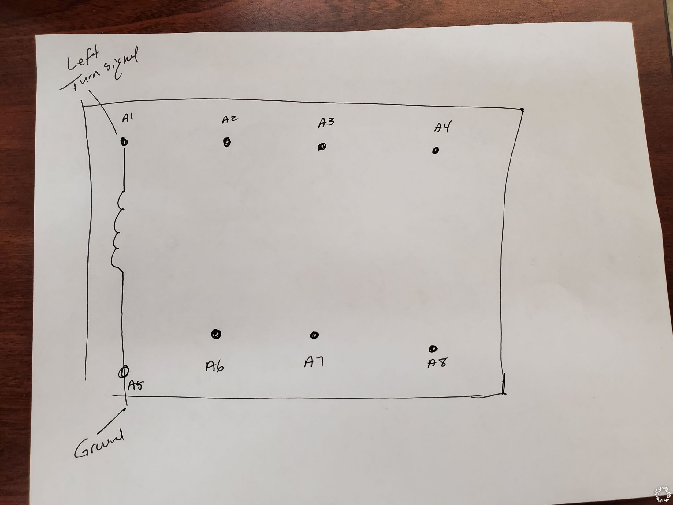

Base on the below drawings can you write what cables i need to connect to each relay. Using relays for the first time.Two Triggers, One Output - Page 2 - Last Post -- posted image.
Taking relay 1
A1- Left turn signal
A2- 12v from battery
A3 - Empty
A4- 12v to the camera and 12v to trigger
A5- ground
A6- rca cable from camera
A7- empty
A8- video out to mirror

You need to wire the relay coils directly to the turn switch (not to the pulsing 12V to the bulbs). On most vehicles activating the turn switch grounds the input to the BCM so that is the way I have shown it in the schematic. Meter your switch to verify that it is switching ground and not 12V.
btw. You might consider leaving the 2 cameras powered up continuously because there may be excessive delay for them to power up properly and stabilize each time you apply the turn switch.
