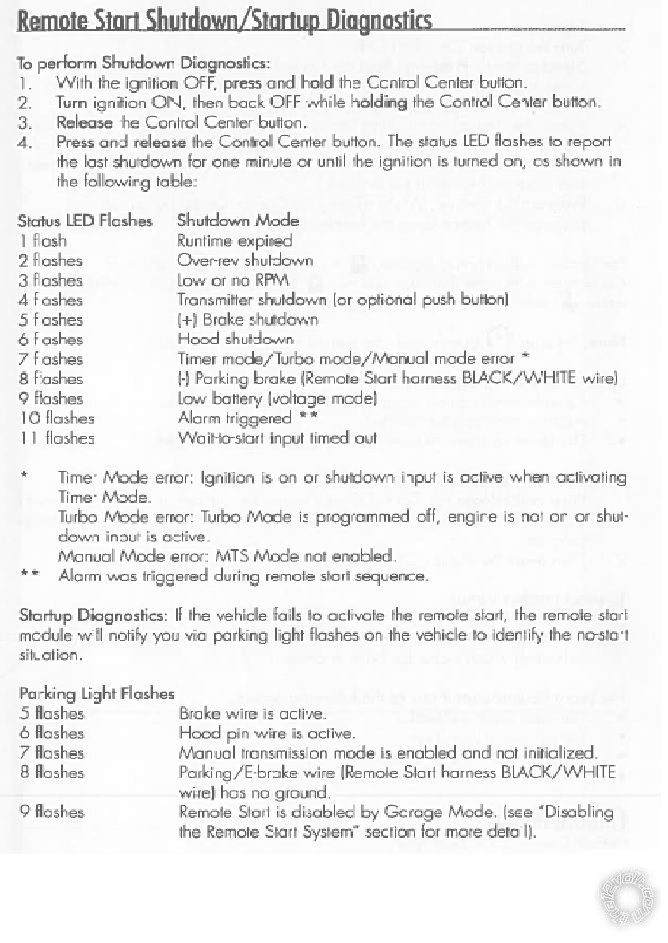

Hi and thanks- the Viper Shutdown Diagnostics you refer to - how to access- XK loader 3 - of so what modules?
Platinum - Posts: 7,828
Posted: December 27, 2020 at 7:33 AM / IP Logged Link to Post Post Reply Quote kreg357
I haven't upgraded to the XKLoader3 yet. I still use the BitWriter. Here is the Shutdown Diagnostics routine :

Posted: December 27, 2020 at 8:14 PM / IP Logged Link to Post Post Reply Quote itolond
Did a diagnostic - an yes it indicates low or no RPM - suspected as such

Posted: December 27, 2020 at 8:27 PM / IP Logged Link to Post Post Reply Quote itolond
Few things based on investigation thus far... I am getting 3 led flashes from control = No or Low RPM, I can confirm the instrument panel is showing RPM correctly.
