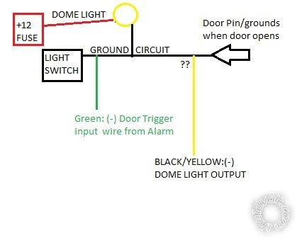

thanks up front for the help! Installing a VIPER 5806v alarm in a 1964 Chevy Impala with Door pins that "ground" when the door is opened. I have it all connected except the BLACK/YELLOW:(-) DOME LIGHT OUTPUT and it all works fine. My questions is if I can connect this BLACK/YELLOW dome wire to the same location the Green (-) DOOR TRIGGER INPUT wire is connected? I don't want to blow either circuit. I assume the DOME LIGHT OUTPUT is a NEGATIVE/GROUND that only activates when the alarm is turned OFF, "this output activates when disarming /unlocking the system and when turning the ignition off in the vehicle". I am assuming that the green wire is detecting a ground when the alarm is ON and thus the DOME LIGHT circuit would be OFF during this time. When the alarm is turned OFF the alarm turns "off" the sensing for the GREEN wire and activates the GROUND for the dome light, basically always opposite of each other. Seems simplistic but again, I don't want to fry my module. I included the a wiring diagram based on the cars wiring schematic. thanks again for the help!

Page 9 of the installation manual gives description of the dome light output. It is a negative output, but is limited to 200mA.   200mA is less than most incandescent bulbs, so the output would need to trigger a relay. The relay contacts would then supply a negative output to the domelight circuit. Don't forget that the car may also have courtesy lights in parallel with the dome light.

Thanks for the reply and info. based on your feedback just add a relay to supply a negative output to the circuit. So the dome/door pin can both connect together at the same point without hurting either circuit. thanks again!
