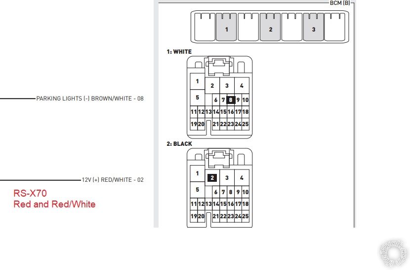

Aside from the RS-X70 thick Pink/White and Orange wires, did you connect the Red and Red/White wires to +12V constant power? I would use this wire at the BCM shown below :
2008 Chevrolet Impala Not Charging With Remote Start - Last Post -- posted image.
If yes, verify the fuses, +12V at the Red and Red/White wires at the R/S plug and that the Pink/White and Orange wires have +12V output during a R/S.
