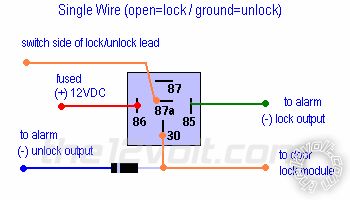

The door locks in the 2000 Range Rover are type "F", single wire door locks. Wiring should be as follows:
2000 Range Rover, Keyless Entry and Remote Start - Last Post -- posted image.

not being a nay sayer, I was reading the factory wiring diagram to identify the wiring and color routing. since I cannot paste on page I have loaded image on accessories under 2000 range rover. let me know if you come to the same conclusion. when testing, I had difficulty finding a dual signal purpose lock unlock wire thus could not use "F" diagram thus begun experimenting with the other diagrams.

GREEN/RED (TYPE F) @ DRIVERS DOOR MODULE in DOOR
Pin 1 of M153 in the drawing which you uploaded.

Lectric, thanks for taking the time to review and respond. I don't do system installs to the public, but being a mechanic I play with my vehicles and to that my play time is very limited. today I revisited the lock issue on my land rover, I wired for type "F". these are my findings, when I use the factory fob all works well when I use the aftermarket nothing happens. when I probe the relay,at rest I have 12v on terminals 87a, 30 in addition to the fused 12v on terminal 86. the diode does it's work well and of course totally neutral (no signal positive or negative), the relay does click when any fob is used but again the function only takes place when using factory fob.
I probed the harness and found out that orange black stripe "OB" shows 12v when locking and orange pink stripe "OK" shows 12v when unlocking green red "GR" and blue red stripe "UR" show continuous ground no matter lock function, pink black stripe "KB" also shows 12 v signal when locking but if I wire it in to the circuit, it blows the fuse to the door out station on becm and tho the 12 v supply to relay circuitry.

In the drawing which you uploaded, the Green/Red (GR) wire between pin 1 of M153 (Left Front Door Lock Actuator) and Z243 pin 5 (Left Front Door Outstation module) is the correct wire. For the CDL switch shown, the Lock function is "0" and the Unlock function is "1" for the switch. When the door is locked, the module should see an open pulse, and a ground pulse for unlock. These this by sing a voltmeter, with the positive meter lead on +12V constant, and the negative meter lead on the door module wire. Your meter will read 12V when unlocking/unlocked with the CDL switch and no voltage when locking with the CDL switch. Not sure about your particular vehicle...the wire color may be different, you always need to test. If this is what you find, the type F relay circuit should work.
From your testing, the OB wire is the lock motor lead and OK is the unlock motor lead. You could use these wires with 2 relays (one for Lock and one for Unlock) to lock and unlock as follows:
Pin 86 to fused +12V constant
Pin 85 to Remote start lock or unlock
Pin 87 to +12V fused constant
Pin 87A to Module side (Z243) of wire
Pin 30 to Motor side (M153) of wire
If your vehicle has a factory alarm, you may need to separately hook up factory alarm disarm when using the motors to lock and unlock.
