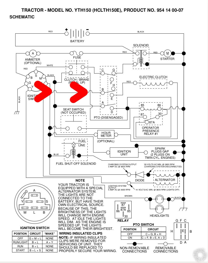

What Does Upside Down U Mean?
What Does Upside Down U Mean In Diagram? - Last Post -- posted image.
lindylex
Member - Posts: 10
Joined: February 11, 2021
Posted: May 10, 2021 at 8:02 PM / IP Logged Link to Post Post Reply Quote lindylex
I have a strange feeling it is the same meaning as union or overlap as it does in math.

Posted: May 10, 2021 at 8:04 PM / IP Logged Link to Post Post Reply Quote the12volt
That indicates there is no connection where the two wires meet/cross in the diagram. The black dots indicate a connection.
