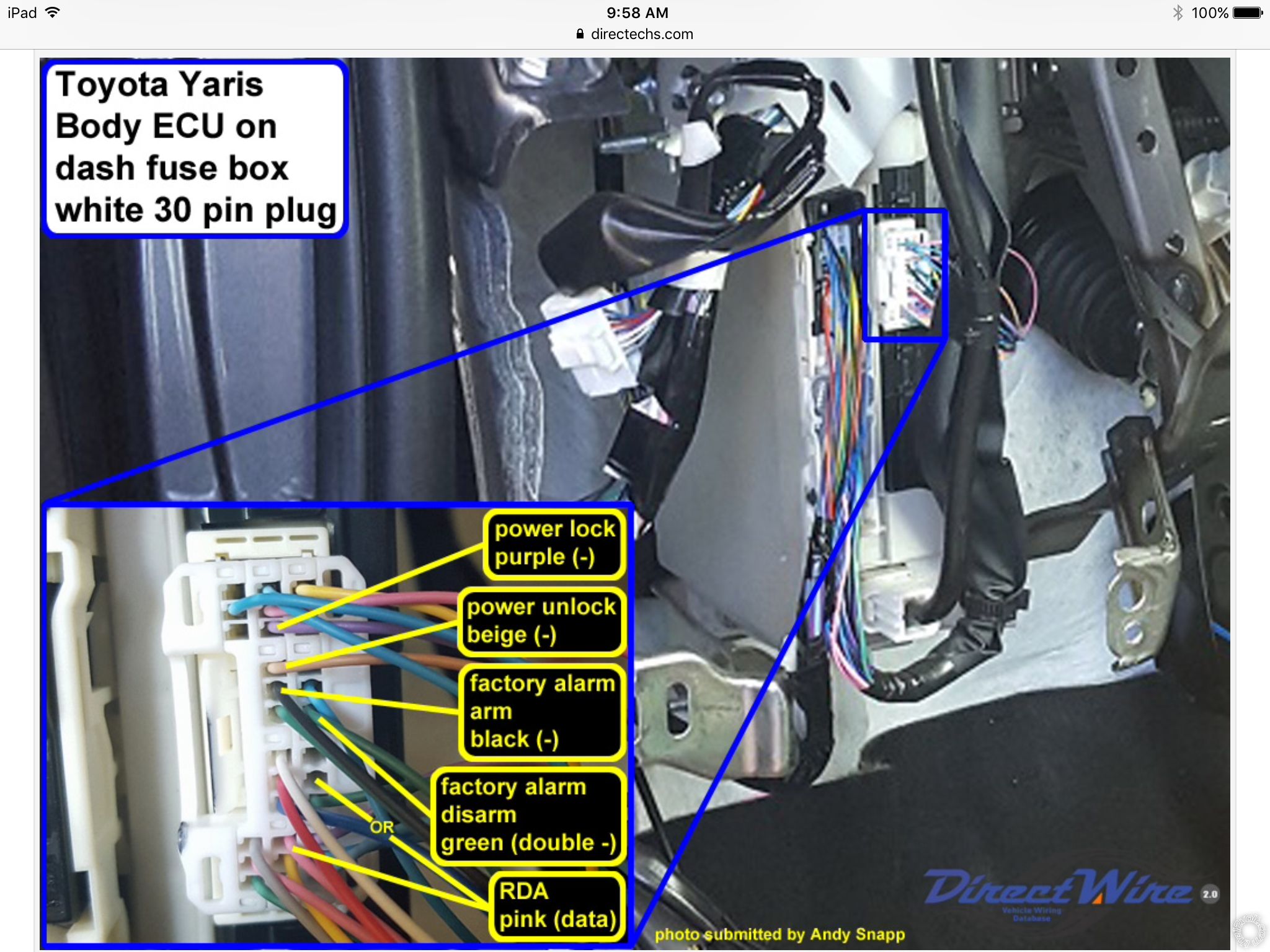

I am installing a Viper 412V (211hv) keyless system. I understand this is a negative trigger. On the ECU connector, what wires do I connect the Green/blk and Blue/blk to? Any help would be greatly appreciated. Thanks.

Power Lock     violet     -     Body ECU on dash fuse box, white 30 pin plug, pin 9
Power Unlock     beige     -     Body ECU on dash fuse box, white 30 pin plug, pin 10

Thanks for the reply. I have hooked the wires up those colors, however it does not actuate the locks. I seem to be missing something. I have the black, purple/purple violet hooked to ground.
The white/black, and brown/black are not connected. Still trying to understand what I didn’t do correctly. Any additional help is very much appreciated. Thanks.

the white/black and brown/black are not used. the purple/black and the purple wires should be going to to ground

2018 Toyota Yaris L, Keyless Entry Wiring - Last Post -- posted image.
Any information as to how to handle the factory alarm able and disable? Do they need to be connected as well? ECC white 30 pin plug, black and green wires.
It seems I’ve done everything correctly, but it’s still not working. Many thanks mgoetz74!

It’s now working. My connections using Automotive taps were both not making good contact. Problem resolved and I now have keyless entry. Thanks again mgoetz74
