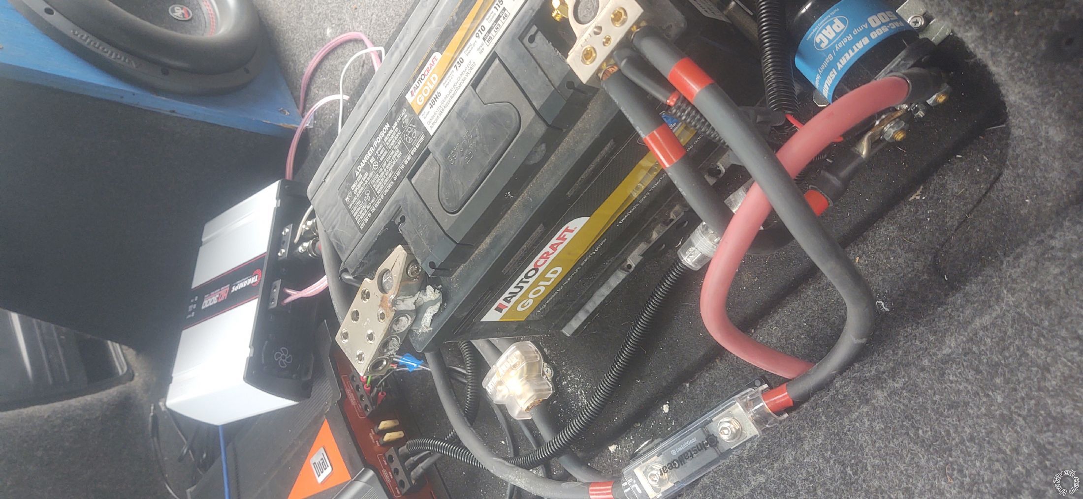

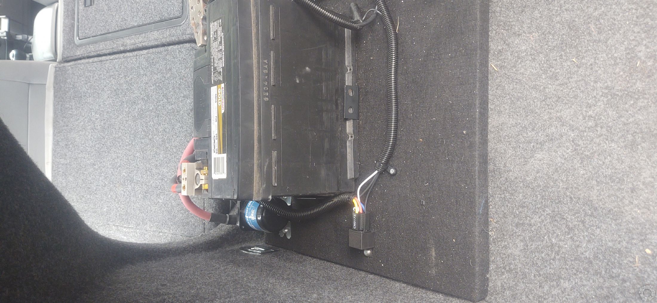

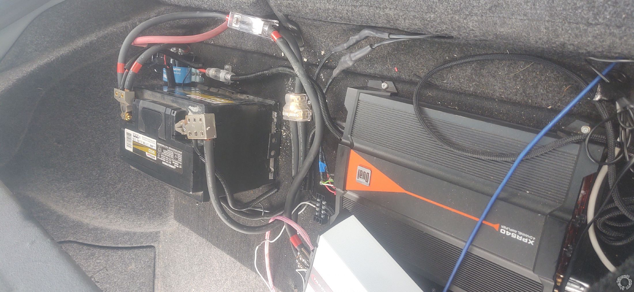

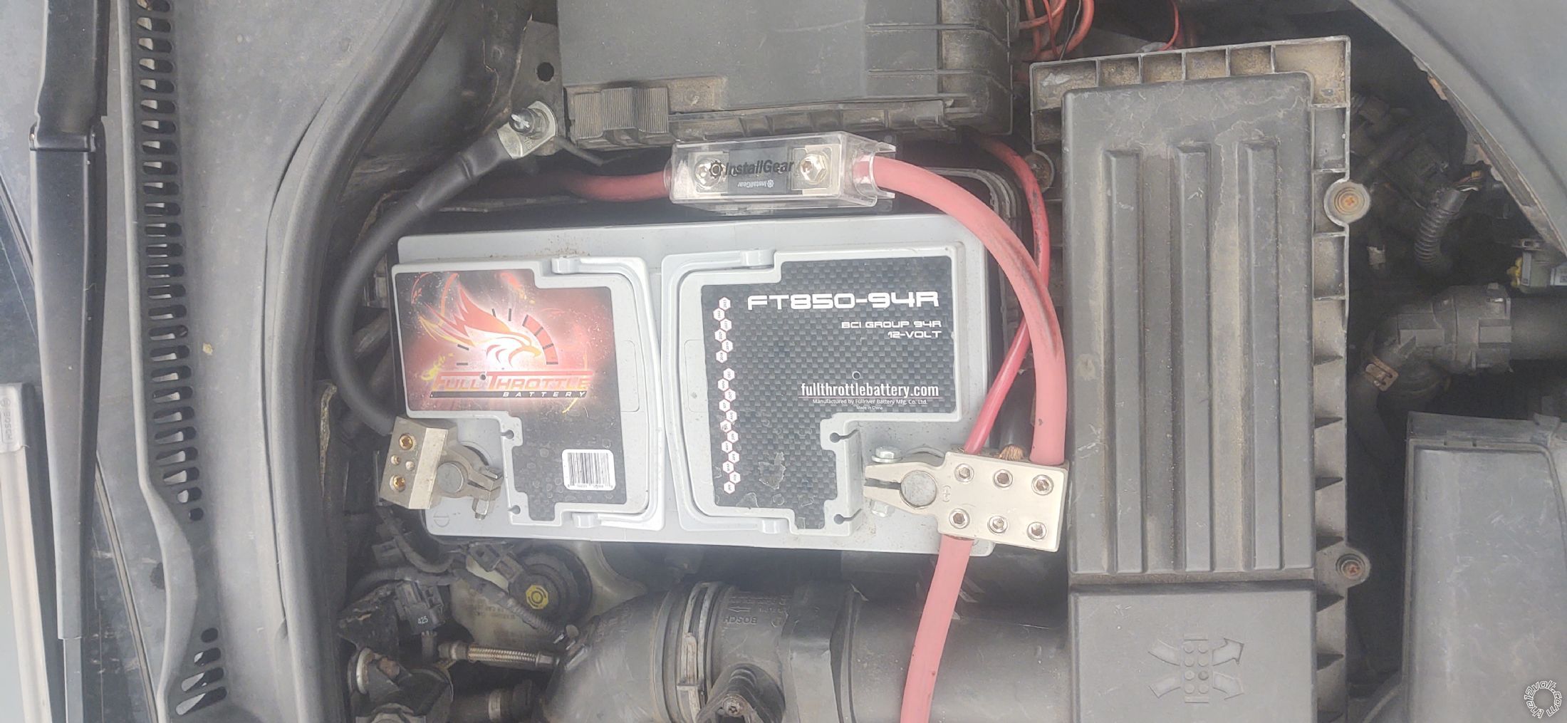

Hi Team - If this question is already posted please point me to the forum/link where I can find an answer. I added a 2nd battery in the trunk of my Jetta, run in parallel, the 1/0 POS+ for the second coming off of the + terminal on the primary under the hood, 1/0 + from alternator to primary battery, only. I have a 250A battery isolator that is connected to a relay so it closes when ignition is on/opens when off.
Question is this: When the car is on, stereo on, everything is powered up and running and the isolator is in the Closed position acting normal, will my amplifiers pull off of both batteries? Or just the 2nd AUX battery?
I'm curious because my 2nd battery is junk and I'm waiting for a new one I ordered at Sonic, and when I turn it up with bass gain high, the bass amp (Taramps HD 3000.1 running single 12" Audiopipe XPsomething 2500W(?) 4ohm DVC wired at 2ohms) I turn it up and the sub amp goes into protect. I'm not surprised because the 2nd battery is cracked and leaking (I stuck bubble gum on it while I'm waiting for the new one) Wouldn't the amplifiers draw off the primary under the hood if the secondary does not have the power needed?
No capacitors, the batteries are ~6' apart, Big Three done, replaced sub amp RCA interconnects, re-grounded. This is the second new amplifier I've had do the same thing (before it was a SKAR RP 2000.1 that did it first, I unloaded that amp after the mfr "did a full diagnostic scan on it", twice, and it persisted.
Any help and insight is greatly-appreciated, Thank you in advance. Work in process, please excuse the mess.

wow that's really over kill for that amp that's in there. Second battery is mainly for extended key off time (according to mecp basic book). Your suppose to use the same battery for front and rear as well, better hope the one in the trunk doesn't vent into the car and the what looks like corrosion on the ground terminal scares me. At least they used a battery idolater. Unless you are pushing extremely high wattage your better off just doing the big 3 (replace alternator, wiring from battery to alternator and battery). personally id take it (2nd battery and isolator) out and run the amp to the front battery
