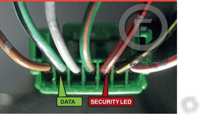

I have found a few wire color errors in the iDataLink install guides over the years but that's very rare. You posted that the Fits' Data wire was Green/White but the install guide lists it as Light Green/Black. Below is a photo from a Fortin install guide that shows that connector. Their photo and wire list both have that Data wire as Light Green/Black. I would double check that connector and your wiring. If there is no Light Green/Black wire, go by the pin position.

Data connection wire... I was not in the garage when I was posting this so I mixed it up. I actually have it hooked to the light green/black per the idatalink manual and the picture above. Second pin is data and the red/black for security LED. Green/white is listed as data on an online diagram I found for a 2007 Honda Fit. There were some discrepancies between the online diagram and the idatalink manual. I have been following the idatalink manual and all wires have so far checked out. One interesting thing to note is ignition harness has the 7 pin connector I currently have all three bypass wires hooked to as well as a 6 pin connector. The 6 pin connector does have a green/white. I have not hooked anything to it for fear of damaging something but not sure if it is a coincidence or if the idatalink manual is wrong and the online diagram has this one right. Any thoughts?

Plug looks exactly like the one in the picture. Is the security light wire just for the dash status light and the only important wire is the orange/black for data?

Checked out the manual and yes that is what it looks like under there. The 7 pin plug.. light green/black is the one I have the orange/black going to. Could the wiring diagrams have the wrong wire? Maybe a stretch that both idatalink and fortin would have it wrong. I tried searching for 2007 Honda Fit wiring diagrams but nothing showed which wire was which on that connector.
