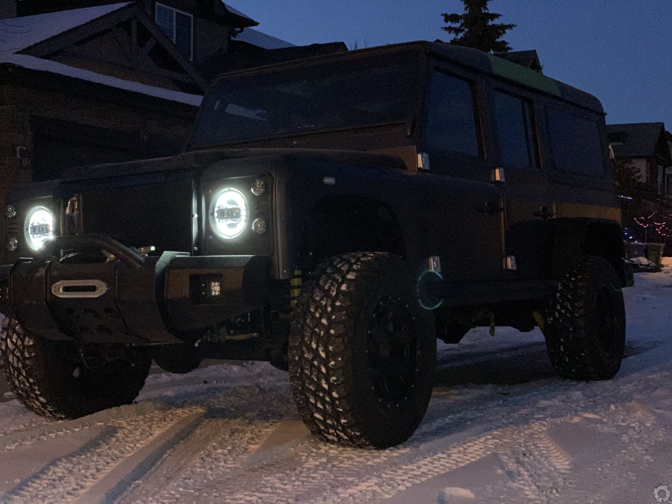

It’s a 2001 Defender 110 that I stripped down to the frame and swapped in a new Gen 5 GM 5.3/6l80. I don’t think I even reused a single bolt lol. It’s been a long few years but I actually got to drive it up onto a flat deck to get it here. If I get my wiring all cleaned up I should be able to get it on the road by spring.Viper 5906V Door Lock Pulse - Page 3 - Last Post -- posted image.

That's a nice looking project. The parking light wire is also accessible at the headlight switch. It should be red at pin 2. Viper 5906V Door Lock Pulse - Page 3 - Last Post -- posted image.
