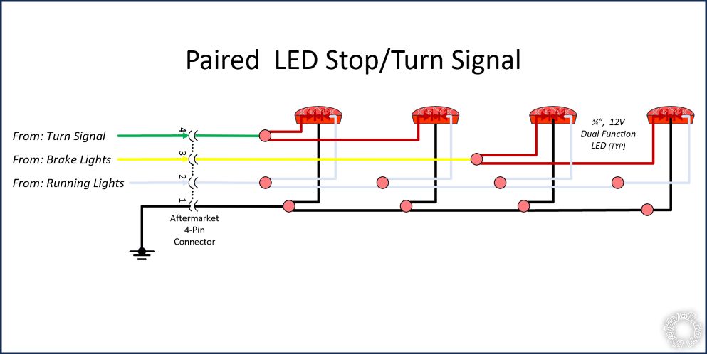

If I understand you correctly it would diagram like ths:
3 Wire LED Issue - Last Post -- posted image.
